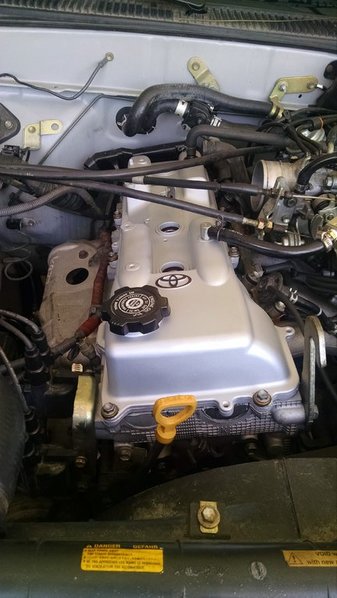

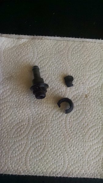

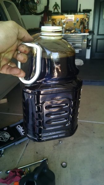

    I would like to say that I changed the oil in my sons 2000 Tacoma but I would be a liar if I did. This is trany fluid. The truck had 260k on it with two previous owners. One of them had to of changed it onece because they used rtv on the gasket. The good thing it that it runs like a top. I also replaced all the vacume hoses and a new pvc valve. The pvc valve gromet was not cooperating at all. It decided to break into pieces and fall into the valve cover. :annoyed::frusty::censored:. After a brief moment of insanity. I removed the valve cover and was able to recover all the gromet pieces. I also did a little painting. The new paint has to be good for at least a .50 to a full 1 hp gain :burnrubber:IMG_20150816_114043845.jpg IMG_20150816_114242908.jpg IMG_20150816_132135601.jpg IMG_20150816_121952162.jpg

    A stock 2000 Tacoma will only have FIPG (pink) on the transmission pan. It should not have any other gasket (paper, cork, MLS, rubber).

    If that's the case then that is what transmission fluid looks like at 260k.

    How difficult was it for you to remove the valve cover?
