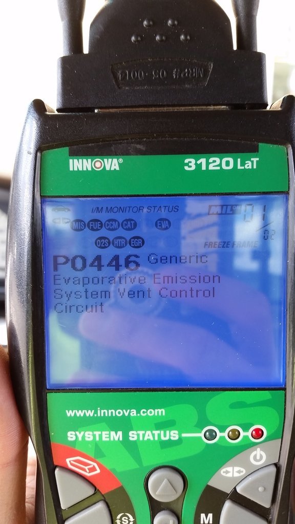

    Was driving home from work and the check engine light came on. Went to oreilys scanned it and came up with this
    Any thoughts on what it might be?

    Nope wasn't that. Evap canister or something? I have no idea but really put the icing on the cake for me today.

    Just sent you the FSM page about 446 code

    I just through this on my 03. It's the VSV located on the canister. It's sometimes referred to as a purge valve.
