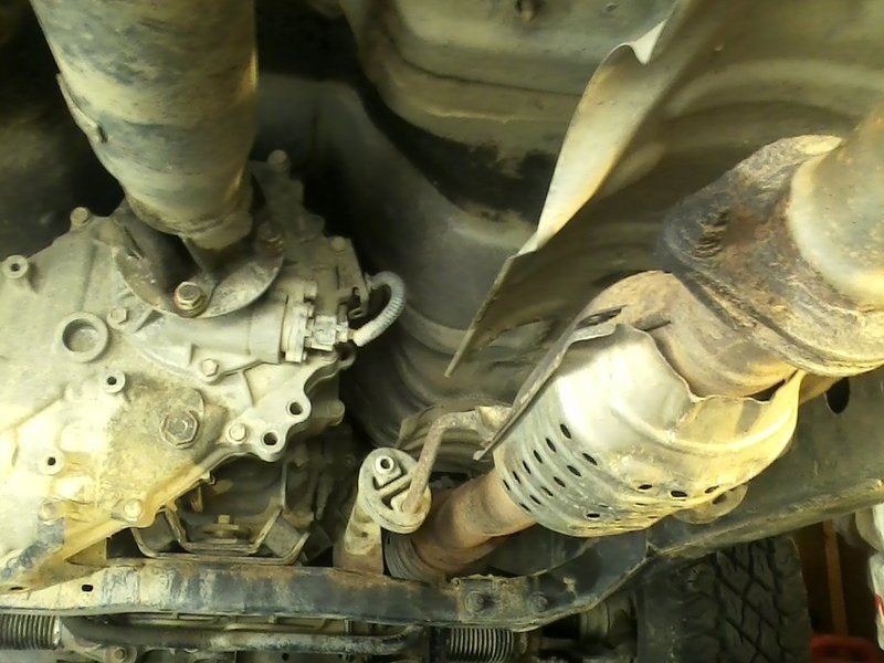

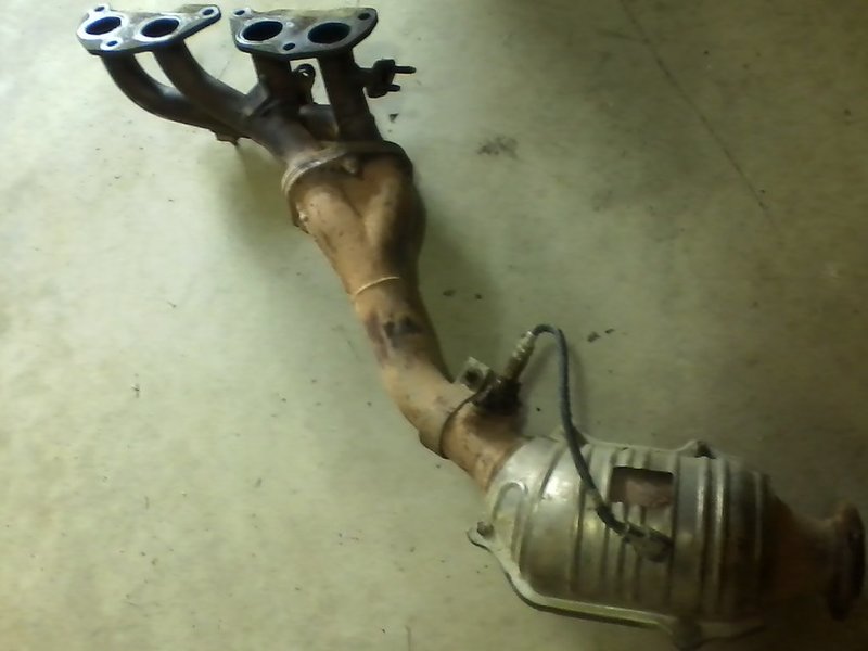

    Putting on the long tube after I grub on some fish n chips.

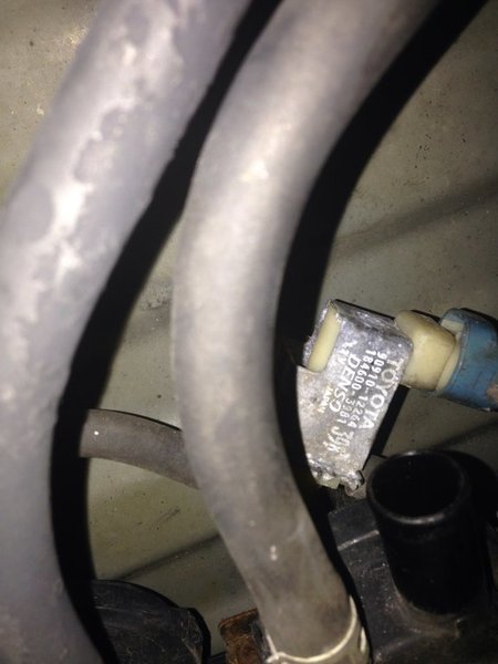

    Thank you for this. Where did you get the vsv at? Local autoparts store?

    Thanks I'll probably have to wait til I get to my computer to look at it.

    I used the part number on the original 90910-11264, to cross reference to a Dorman part number 911-601.
    So far I've logged 2700 miles with no CEL.

    Is it just the solenoid plug itself?

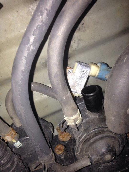

    Yup, just unplug the connector, then the two vacuum lines that are attached. The solenoid is held in place with one small screw. It was pretty simple.
    I dropped the spare tire and unplugged the larger vacuum line to make it easier to get at.

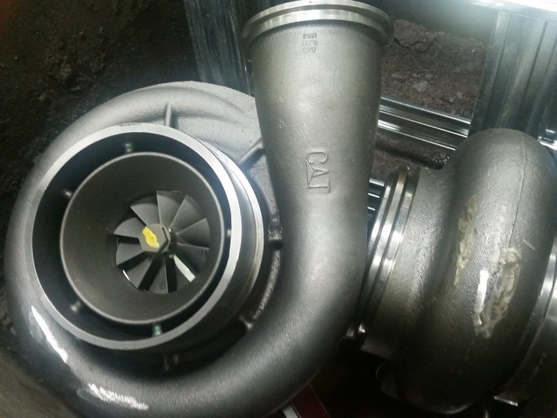

    2 monster sized turbos from caterpillar lol wonder if I could put one in my truck lmao

    Nice! I had no idea this thing was located back there. I thought it was in the engine bay for some reason. Just ordered it from oreilys and I should have it in by end of day Friday so we'll see if that fixes the issue. Thanks for your help man!

    There are more than one VSV's. One is on the charcoal canister and two under the hood. Well on my truck anyway. Can't speak to the 4 cylinders.

    4 cylinders are the same. There's one little one tucked in under the intake plenum. The other is right on the inside of the driver's fender

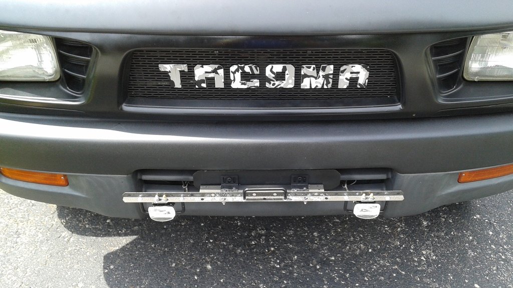

    After a failed attempt to fit these lights behind my satoshi I fashioned a license mount bar.

    So the code could potentially be any one of these 3 vsv's? Or potentially something else?
