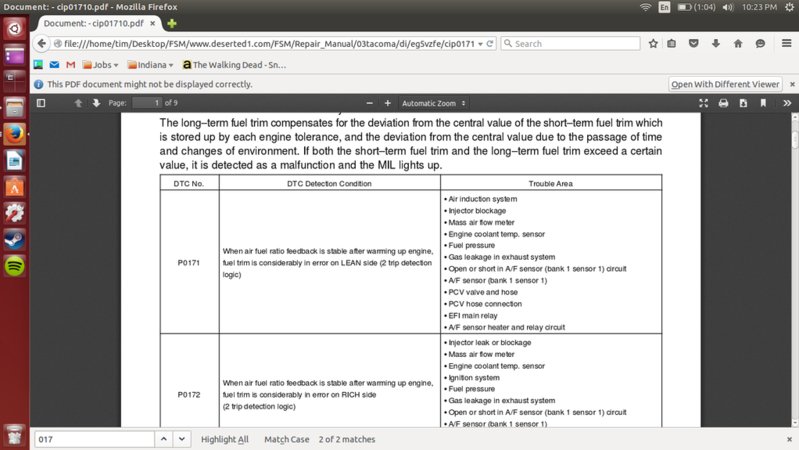

    After scanning, thinking, reading. Could my problem be a dirty IAC or my throttle body needs a good cleaning

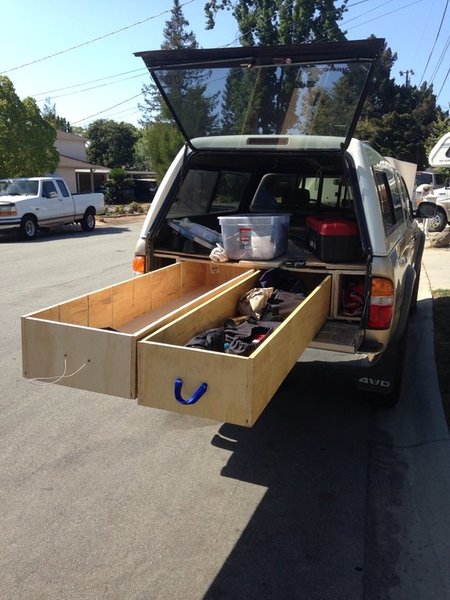

    315
    04 4WD
    sweet buddy. you build that? I think I wanna just be gone with mine for good. I'll put it in storage and keep it if I ever need it down the road. but I have ideas of how to make it all work for work without it

    I did. It's overbuilt and heavy though. I might build a version 3 and hand it off to a carpenter in a few years. I've been driving around with no she'll for a day. It does drive very nice with an empty bed.
