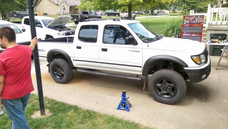

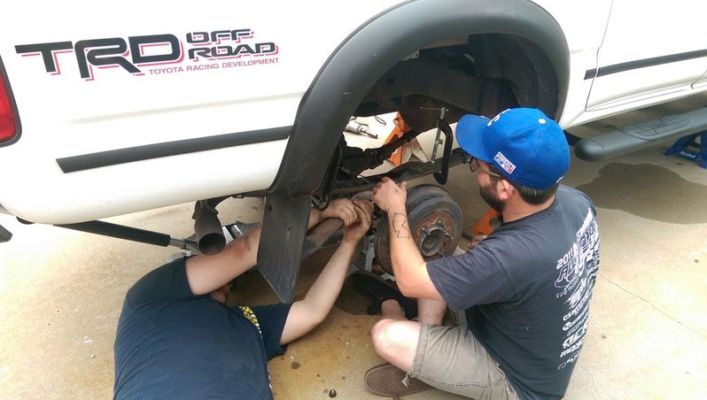

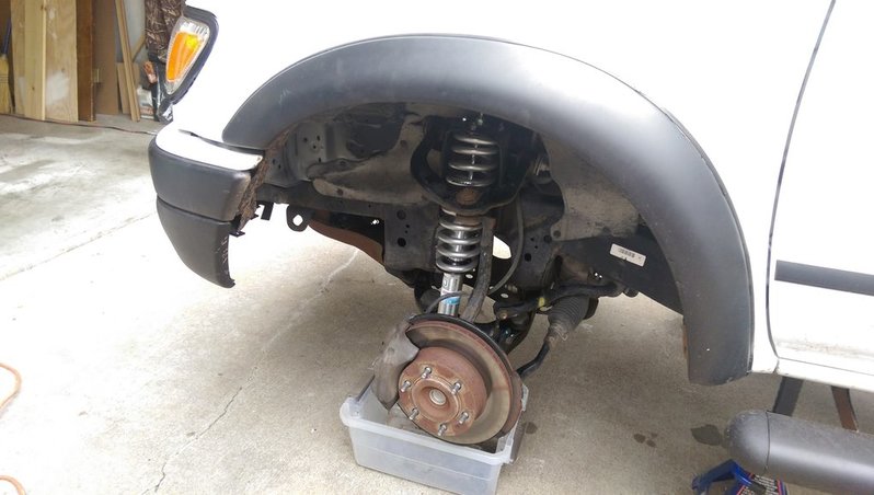

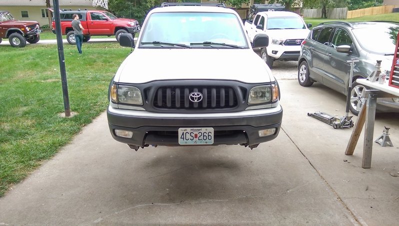

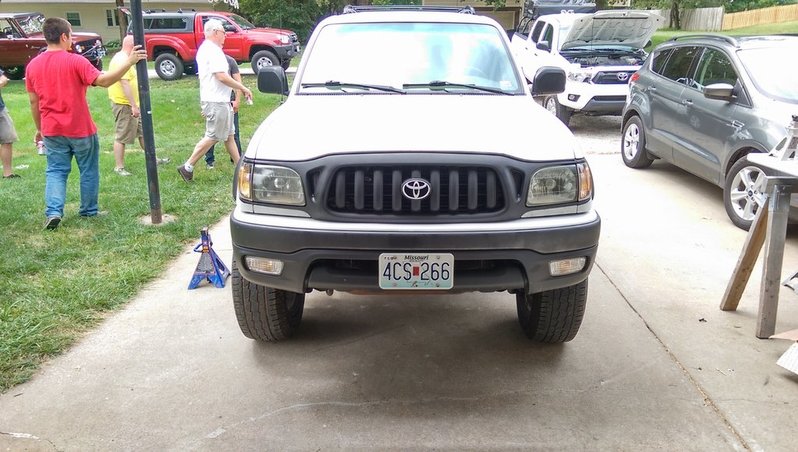

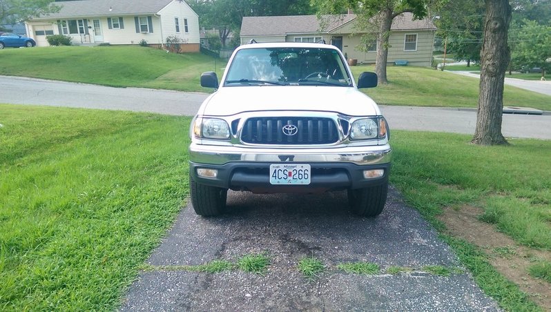

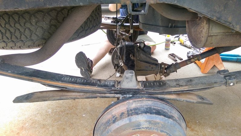

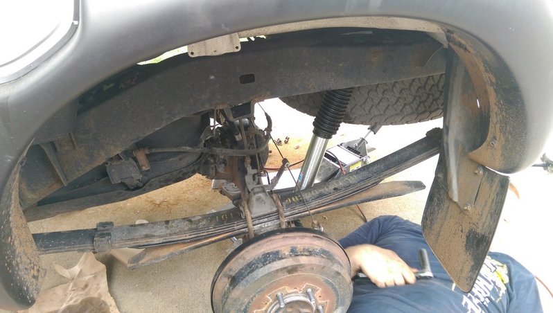

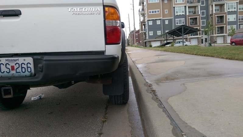

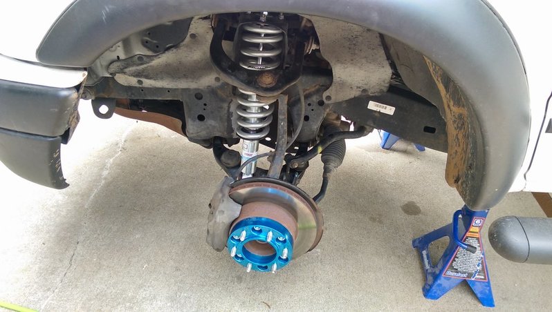

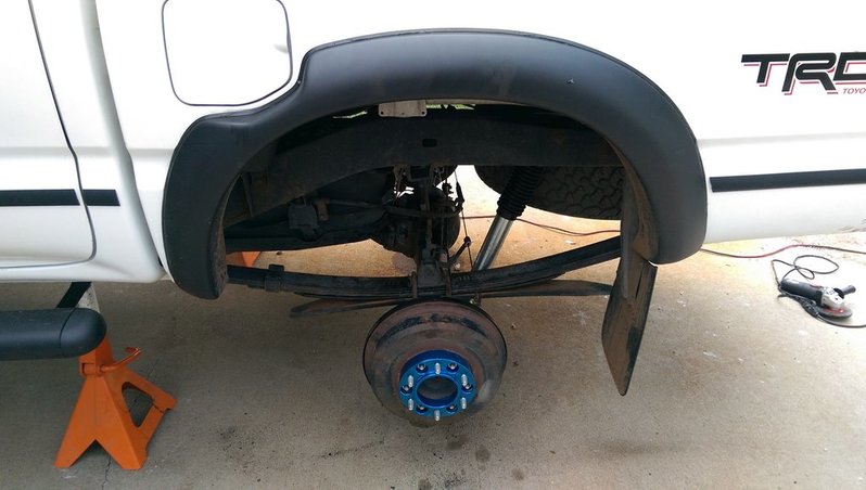

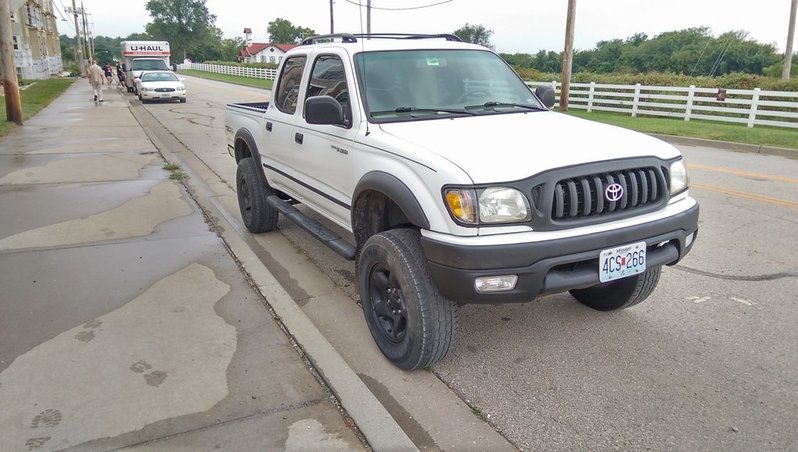

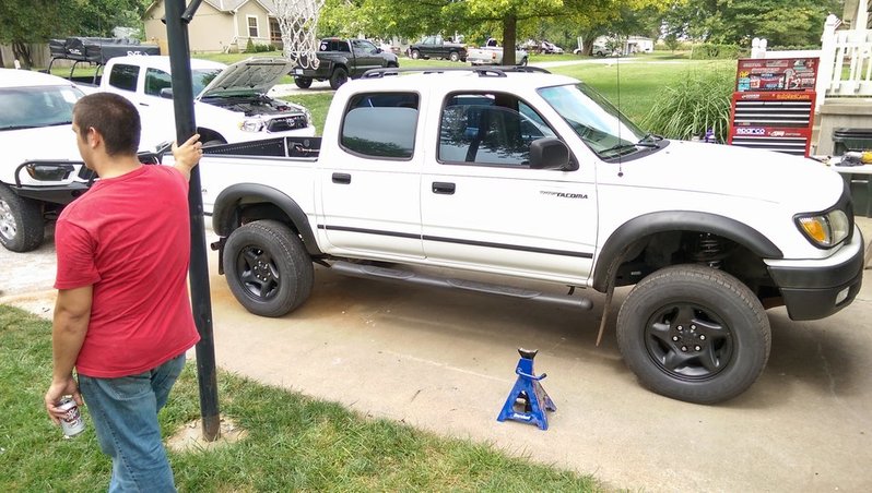

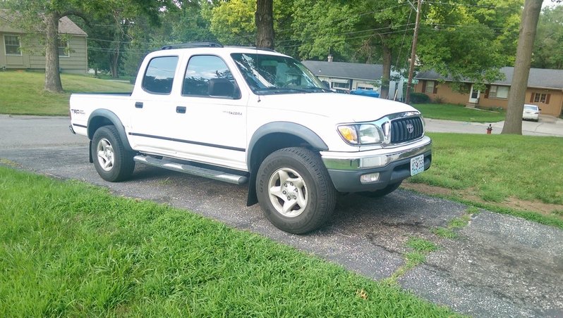

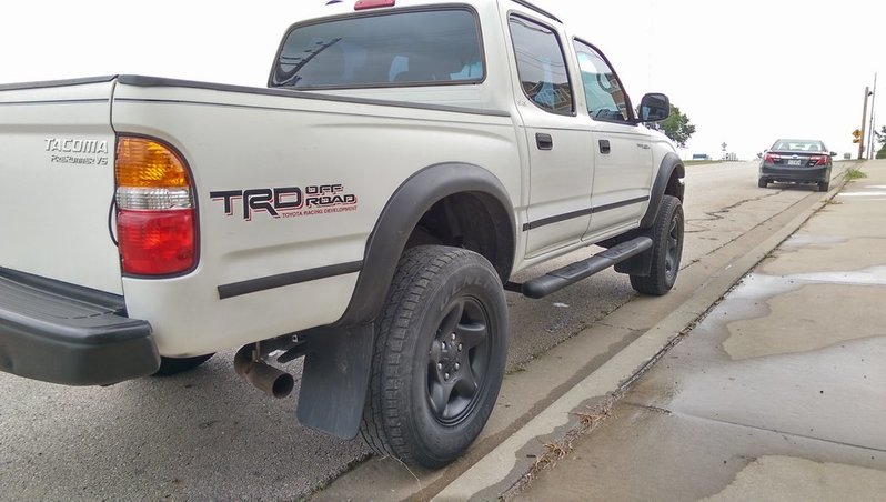

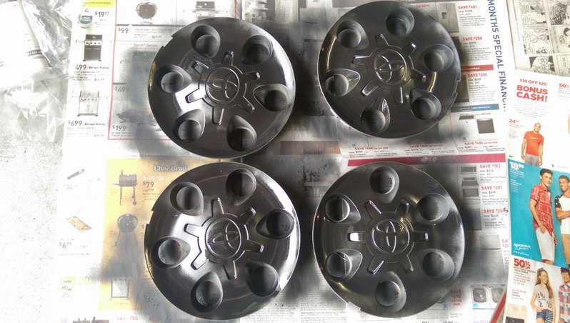

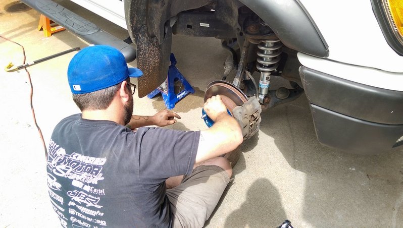

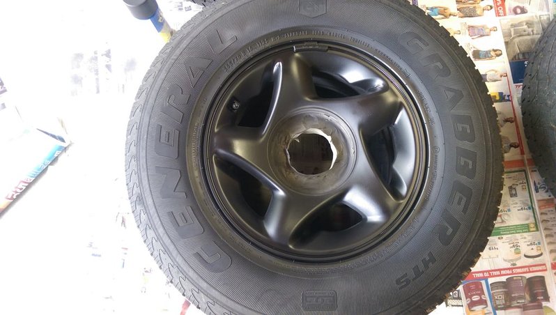

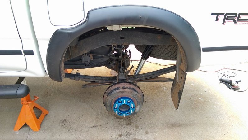

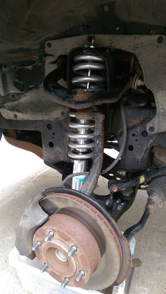

    Installed 3" Toytec lift with 5100s, Eibach springs and Deaver add-a-leafs, and plasti-dipped wheels black with pd glossifier, along with 1.25" Spidertrax wheel spacers. Just waiting on tires, which should be coming in December.
    Ground to fender before:
    FR 34 3/8
    RR 35 1/4
    RL 34 7/8
    FL 34 3/4
    Ground to fender after:
    FR 38 3/8
    RR 37 3/4
    LR 37 3/8
    LF 38 9/16
    Before:
    During:
    Hovertruck!
    After:
    Wheel Spacers
    Completed Product :bananadance::dancingbacon::kona::oldglory:

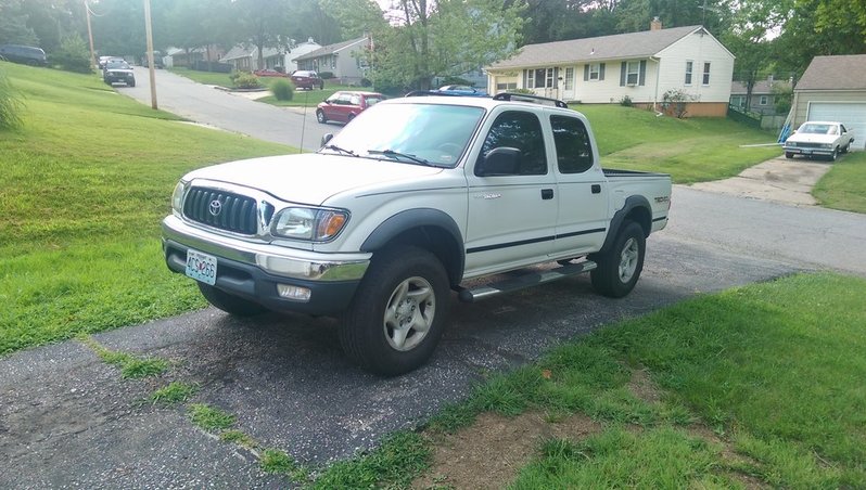

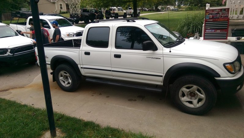

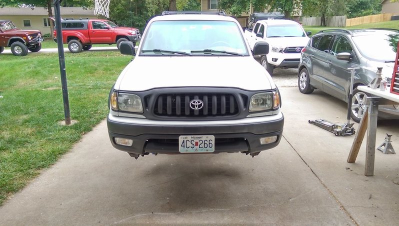

    Install day! Put on 3" Toytec lift with Bilstein 5100s all around, Eibach springs up front, Deaver add-a-leaf in the back, 1.25" Spidertrax wheel spacers, and plasti-dipped wheels black with glossifier. Tires to come in December.
    RF 34 3/8"
    RR 35 1/4"
    LR 34 7/8"
    LF 34 3/4"
    RF 38 3/8"
    RR 37 3/4"
    LR 37 3/8"
    LF 38 9/16"
    Before:
    During:
    Hovertruck!
    After:
