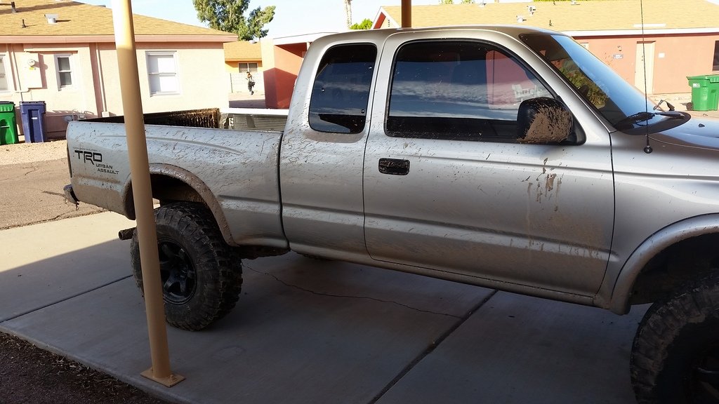

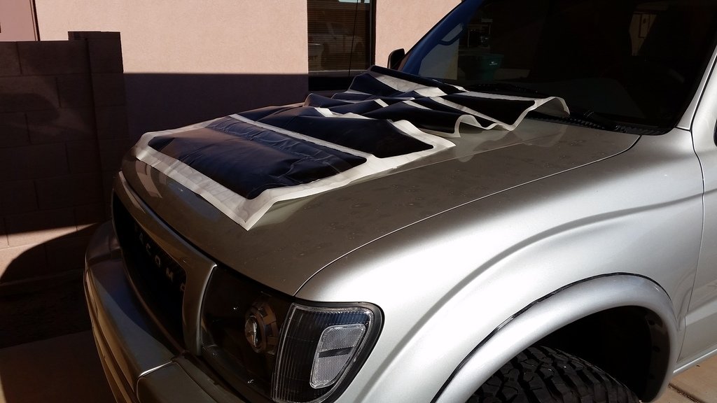

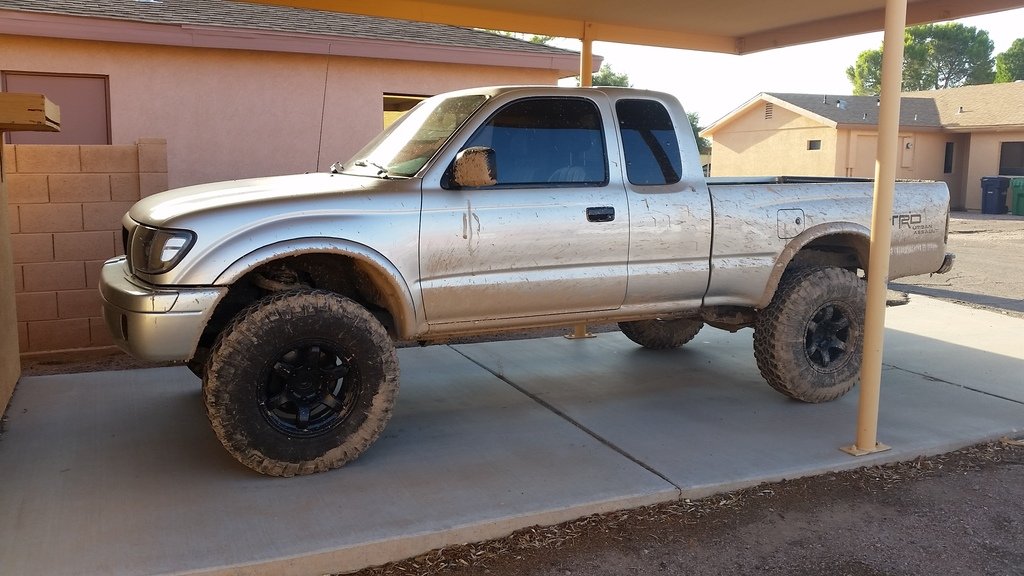

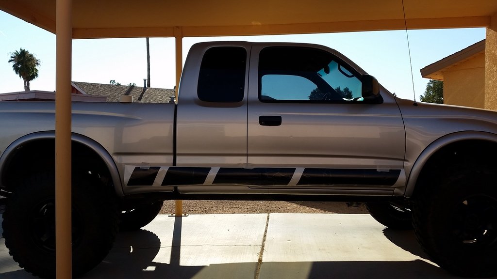

    Last week I cut some decals, last night I played in the rain.
