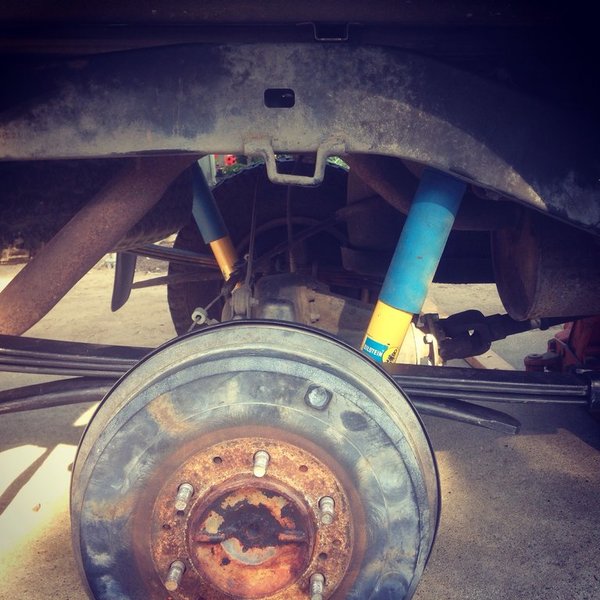

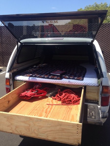

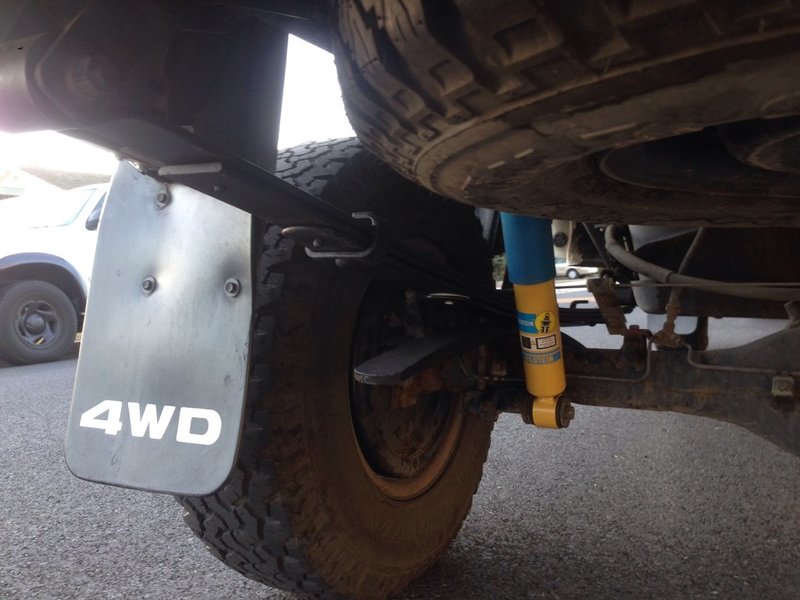

    So a while back this happened:
    Lots of fun wood working and whatnot. Super nice to still be able access everything and sleep in the back without much hassle, but it promtly killed the 16 year old suspension and cupped up my tires.

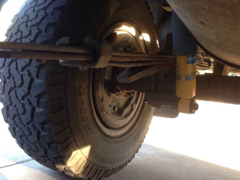

    New shocks were the recommendation, so about two months ago that happened, but the leafs were still unhappy...
    Replaced the leaf packs with intent on adding a leaf at the same time, two weeks ago, but got the wrong leaf, wouldn't fit into the pack, so I returned it and got the correct one.
    (New stock leaf^^^)
    Time constraints meant driving like this for about two weeks. New everything meant a super soft luxury ride that made the taco feel like a Caddy. Which would be great... if I owned a Caddy.

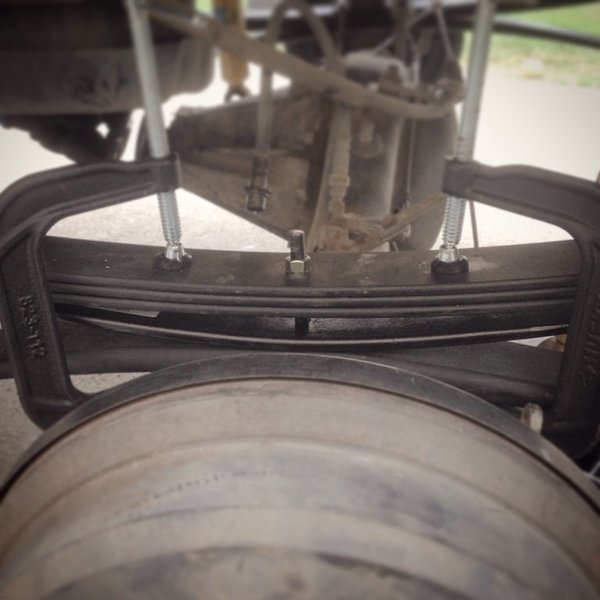

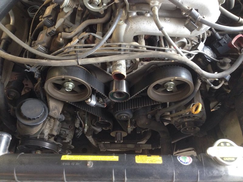

    So I was scheduled to visit some friends this weekend with the primary goal of having my trusty, handy dandy Toyota expert show me the way around the timin' belt swap.
    That only took the morning, he has done "a few" of these before so it was quick and I learned plenty, so we pressed on to do the add a leaf in the afternoon...
    Brake lines were limiting us so for the ease of things we detached and let them bleed, later flushing the lines out, as well as removing the drive shaft. Then we were free to move the axel around as we pleased.
    So 13 hours later, we got a lot of work done for one Saturday:
    Replaced:
    Timing belt (and associated pulleys and tensioner)
    Water pump
    Coolant
    Oil and filter
    Spark plugs
    Brake fluid
    All three serpentine belts
    Then of course the leaf addition. She's a whole lot stiffer now, no Cadillac ride.
    Her ass is a little high but won't be when I sleep back there with all the gear for the weekend in there too, and should settle after a few miles. But the leafs are smiling again...
    Thank God for friends that are willing to help with this stuff, and just so happen to have a garage full of snap-on tools!

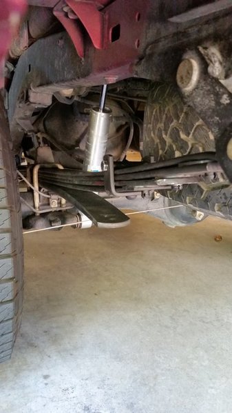

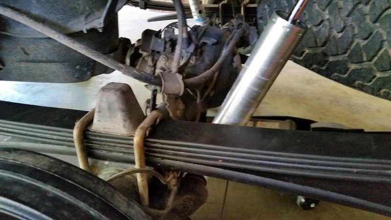

    I added a custom made add a leaf i made from the main spring on my old factory pack. It went on as the third leaf to make a 5 leaf pack. 20150913_115839.jpg 20150913_144907.jpg

    What do you use for your cushion? just egg foam?

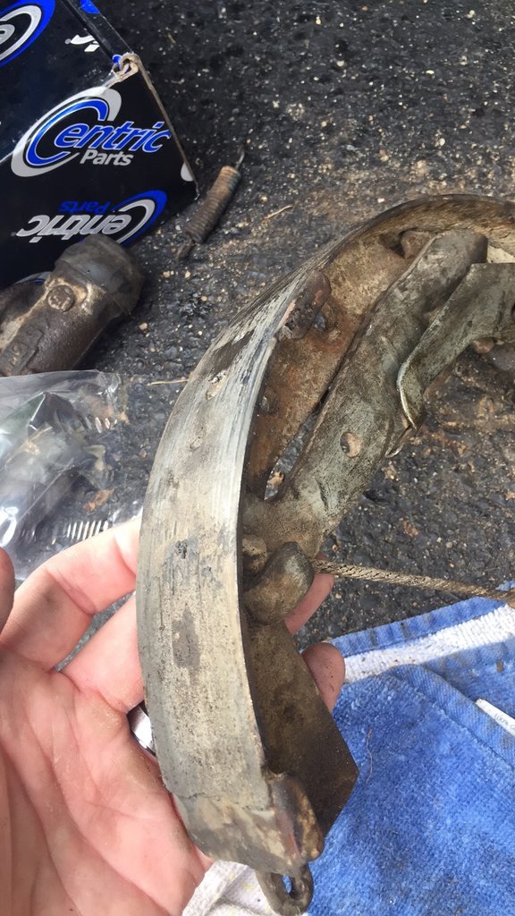

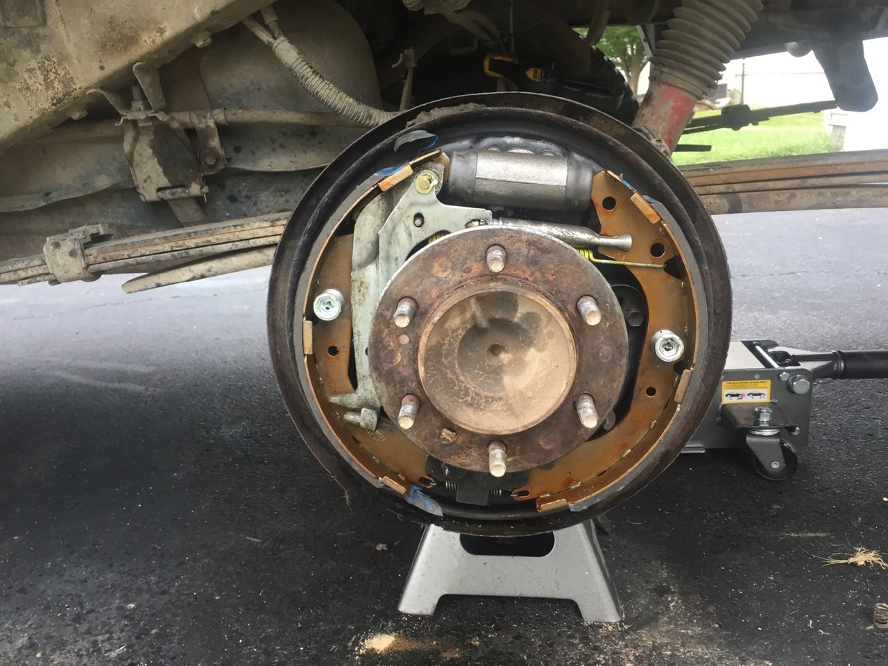

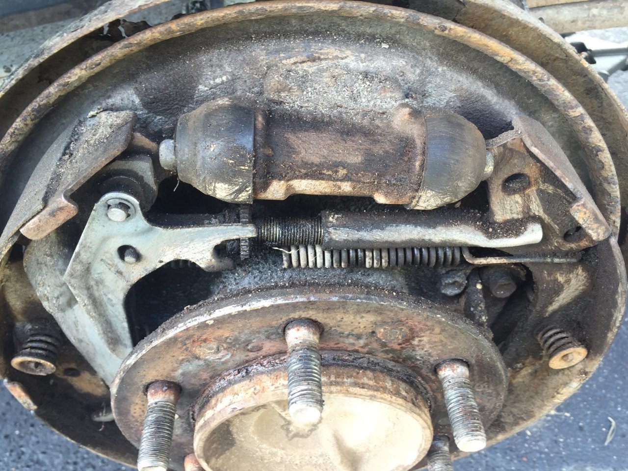

    Drivers side rear brakes. Passenger side is next week.
