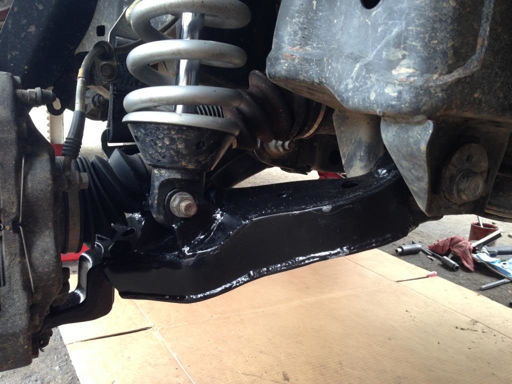

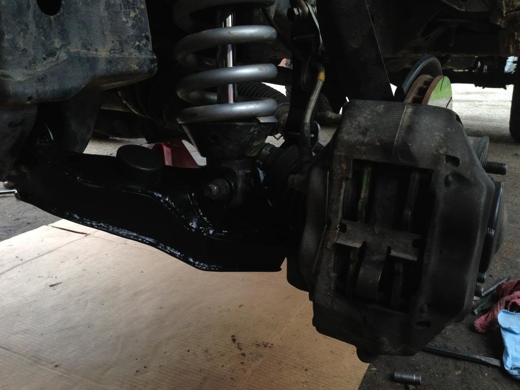

    ...too much shit to list.
    Wheeled the piss out of it over the weekend.

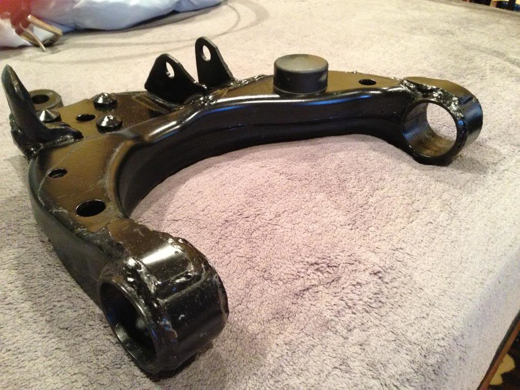

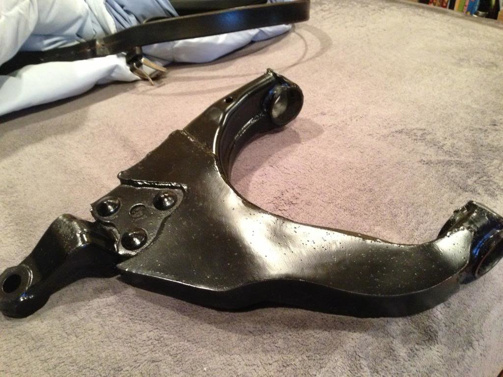

    Yep. Don't bother with the energy suspension LCA bushings. I've been happy with my whitelines so far.
    Process took a total of 15 hours of wrenching by myself to replace the bushings, ubjs, lbjs, and struts. Not terribly complicated, just time consuming.

    I think I'm going to save up and put in ome shocks and springs at the same time as my LCA's.
    Just leaves figuring out where/how. I might have to have a mechanic do it.
    Having them have to cut/burn out the old bushings will be $$ because its time consuming. New lca's might be cheaper

    647
    02 Tacoma TRD 4x4
    In my opinion the Energy Poly bushings are great. I've been running them for about 5k miles now. Only complaint is that they squeak a little. Thankfully i had an extra set of LCA's laying around so i could put in the new bushings in and just swap out the LCA's when it was time.

    Not sure. I tried burning them, but didn't get very far.
    I bought both the Whiteline poly bushings and the ES before I replaced my LCA bushings. I would never recommend the ES because of having to reuse the metal sleeves. Mine were completely destroyed trying to remove them from the arms. Huge PITA avoided by paying a little more in the first place.

    Take a small drill bit and make series of holes all the way around bushing and use air chisel to drive out.
