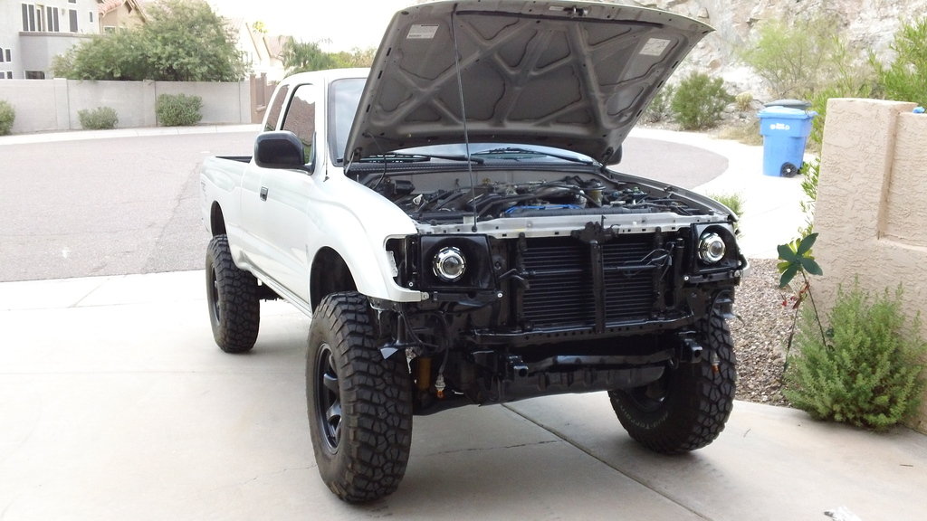

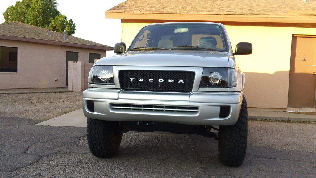

    It was painted at Maaco. There's been a lot of evolution over the past 5 years.

    I love the way i can use your truck to evaluate all the modding ideas floating in my head. I wonder what the plain black bumper with painted inserts, painted grill (like yours) would look like.

    The grille is a good place to start, I've had issues with peeling paint on the bumper.

    What did you do for prep on the grille, or did the paint shop handle that?

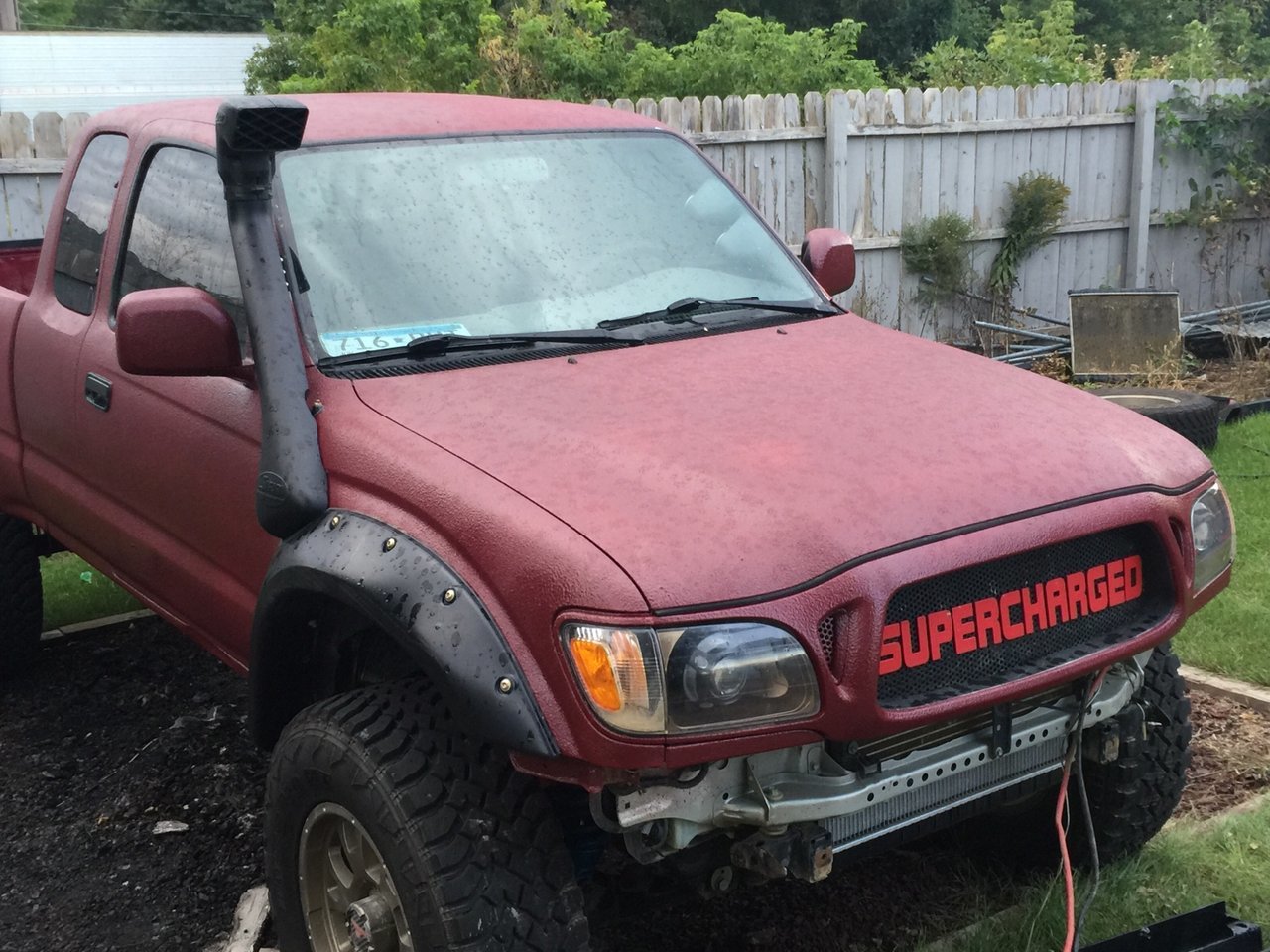

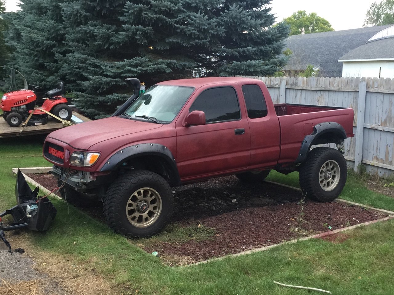

    what did you use? is this monstaliner?

    Yeah it really is only noticeable on the door I think. Looks good though.
    Let me know how it works, seriously researching this for my truck and already have the 1.25 spacers in back.

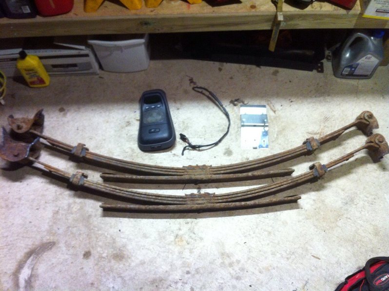

    I have some recent experience with them as I took a rusty set apart and cleaned them, put new bushings and isolators and pins in. The 1/2 ton are 3 leaf and the 3/4 Ton are 4 leaf both with overloads. As you can see in this picture I removed the overload leaf and added a small 5th leaf I had lying around. That leaf will probably be removed as it should be longer but I'm going to see how it works, I have no experience with the 2 leafs as I haven't seen them ever.
    Anyways I would try and find the 4 leaf 3/4 ton, you'll be fine as they are meant for a 3/4 ton full size Chevy, weight won't be a problem, they are soft and will hold weight. Ask @thegame he runs them and was the one who gave me advice when I was looking into it.
    My leafs after I cleaned them.

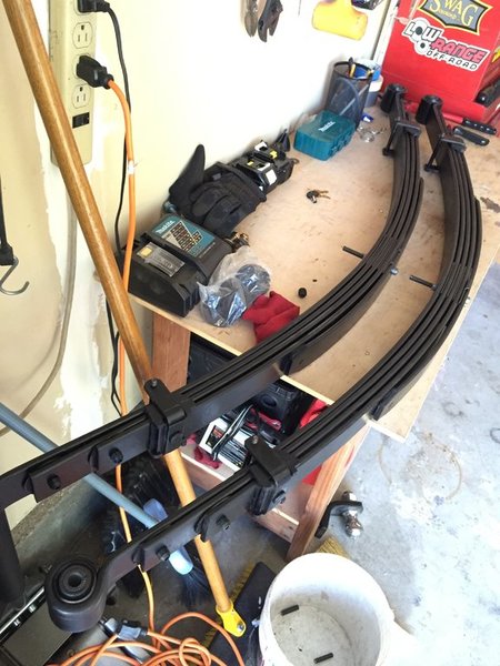

    Google image of the 3 leaf version with overload still on.
