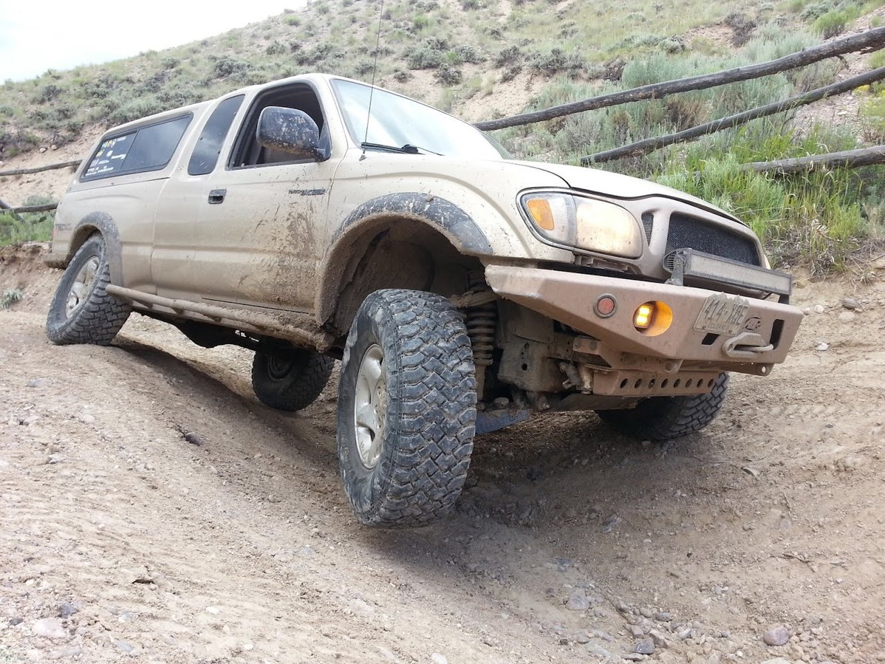

    My 295s are not that wide. And think about it, only half the extra width is adding to the clearance issue.
    So if you compare my 295s to the narrowest of 33s, you gain .785" of clearance to the frame. Also, who the hell would be outboarding shocks and not running bigger-than-stock tires?
    I just think it's very unlikely to come up with a functional outboard setup without a wider axle.

    No. You will need new shocks, the best way to do it is to relocate them since you're rebuilding it anyway. I have 14s, but 12 usually work better and can be easier to mount. And yes you will need extended brake lines

    Idk. Call TC if it bothers you that much haha they have installed it on multiple trucks, some with double or triple bypasses. And run hydros outside the frame as well.
    The shocks are leaned forward which i think keeps them out of the way some.
    Next time i guess look at how close the tire is to the actual frame when its stuffed up in there. I can't say i have ever really looked myself at the clearance.

    I can't see myself going any bigger than the 265x75R16s I have on there now. That's about stock width and -3% on the speedo error.
    Still tho I am anxious about the clearance.

    I wouldn't worry. It bolts up so you can check the clearances before you weld anything really. You don't like it...i'll buy it haha

    I'm not bothered. Just saying I'll be curious to see how it works out for those trying it as I am very doubtful.
    Curious as to where you've seen someone with a stock axle and bypasses & hydros outboarded. Bet it was with a Tundra/T100 axle...
