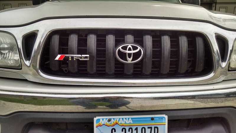

    Added a TRD emblem to the grill because I have no money haha :turtleride: + 5 HP obviously lol.

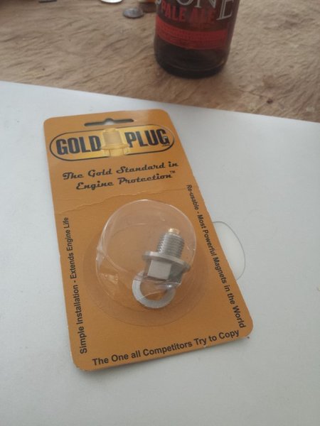

    Did some housekeeping today, new Silverstar bulbs, replaced burnt corner lights with amber LEDs, finished the alternator install with new belts and changed the oil and installed this magnetic drain plug i bought.
    I have the same plug in my BMW, and i always get a pea sized amount of fine metallic paste when changing the oil. I made the mistake of trying to install an extra one i had last time. Toyota's plugs are M12x1.25 thread, most European cars are M12x1.5

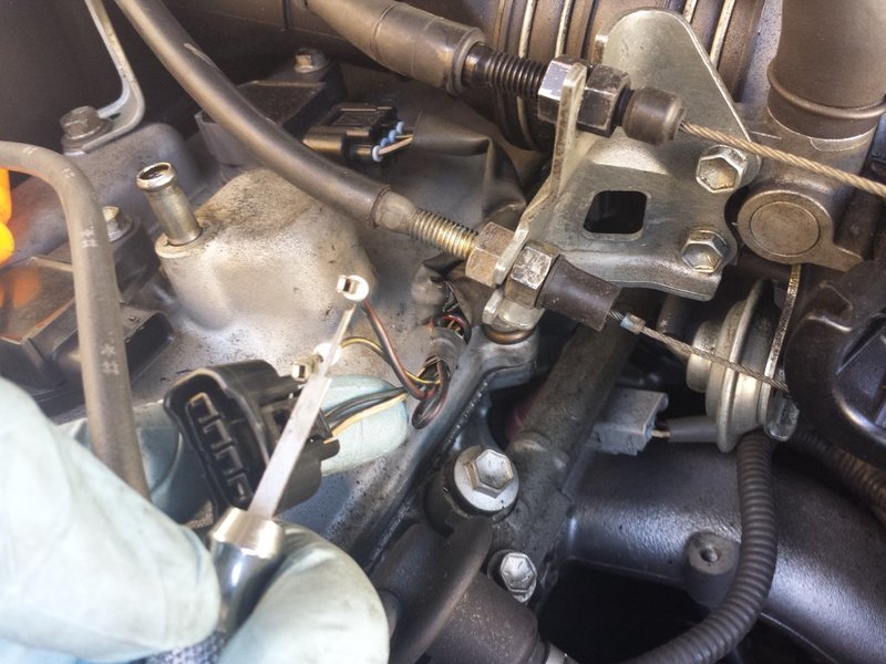

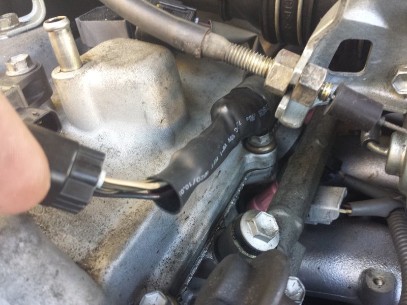

    I was getting a little OCD about the covering off the #1 coil wiring coming off. Using this nifty pin out tool, i removed the pins from the plug and used some 1" shrink wrap to replace the covering.
