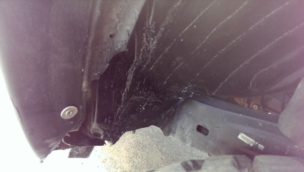

    Don't waste your time hammering the pinch weld because it will be in the way eventually.
    Cut all the liner out of the bottom of the fenderwell, take an angle grinder or something and cut as much as the pinch weld off as possible, and then relieve some stress by taking a BFH to the lower firewall and pound it back a bit. This is what my mess looked like for a while:

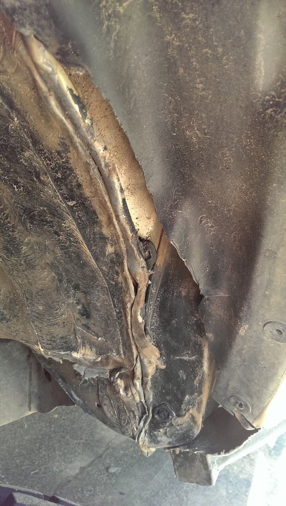

    I've also had to pound some in the upper front of the wheel wells. After about three sessions of doing that, getting tired of rubbing, cutting as much away from the firewall as possible, smashing it with a bigger BFH, and finally when you stop a majority of the rubbing, take some seam sealer and clean the pinch weld up. This is what I have now:

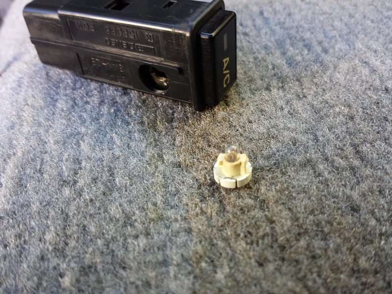

    Is that the bulb that lights up the "A/C" lettering when the parking/head lights are on? Or is that the light that lights up the indicator bar when the switch is engaged?
    How hard was it to get out? I want to change the "A/C" lettering to red.

    It came out of the switch its right next to.

    Yes it is the bulb that lights up only the A/C lettering, however it doesn't influence the color on that switch. It is a thin film of green or orange (depending on year) that cannot be removed without scraping the A/C lettering off (ask me how I know) that actually makes it colored. So unless you know a good translucent decal printer and have a super steady hand there isn't much that can be done to change the color. I tried to make mine light up white and ended up making a couple small scratch marks that now light up in the former black area surrounding the A/C lettering.
    Hope that helps a bit :/

    I see that. But is that the only light in the switch? If so, it would appear that there is a green film behind the "A/C" lettering and the indicator bar.
