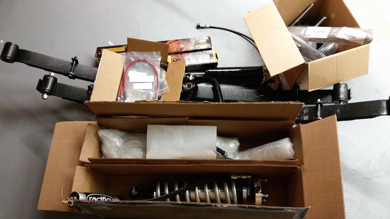

    Installed some parts...
    Then took 'em all out on a shakedown on some un-numbered USFS lake road.
    The 2.5 RR Radflo's are super smooth; I can hit all sorts of exposed rock at speed, no problem. The Wheelers 5 pack, not so much. Tamed the 'British nanny' ride a bit with 120lbs of sandbags, but it feels like they're so stiff they overpower the OME shocks in back. Turns out they're made by Betts spring now. Anyone else go these newer non-Alcan versions?

    For the love of god don't trim or clearance anything that has to do with the stock suspension...
    Yes. You can usually get a better one anyways..
    you can run 700s. I wouldn't advise it unless your have a heavy ass truck though(Plate bumper, winch, full skids, dual battery. 650s will be just fine.
    the 5 leaf packs, at least mine which i will admit are the Alcans :cool:, are stiffer then your stock ones yes. Let them break in. The more you flex em and use them the better they will get. Adding weight helps like you did. Get a rear bumper perhaps is the next step :p
