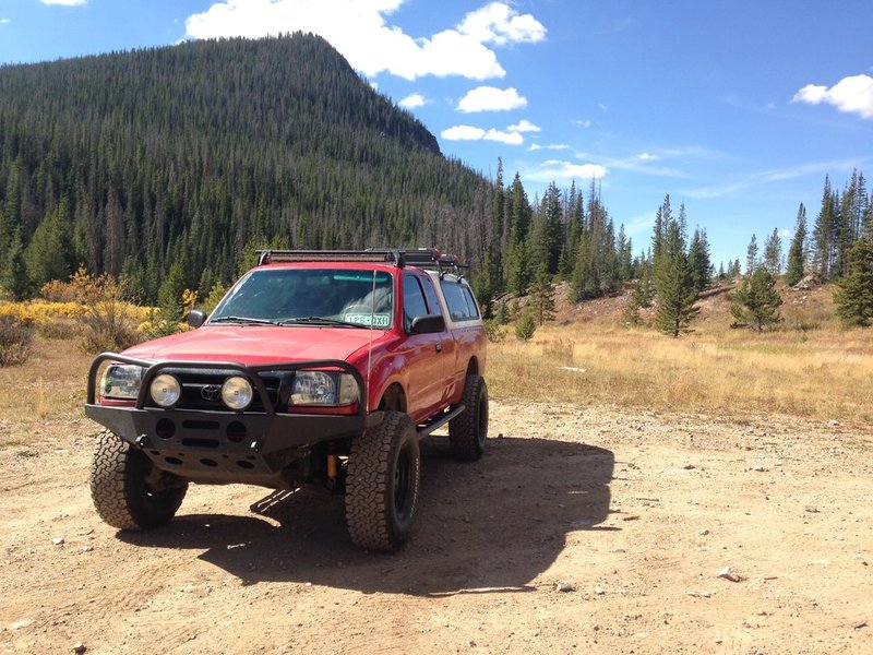

    285's.... Smooth ride minus the steering wheel wobble. Any way to fix it. I assume an alignment.IMG_4815.jpg

    I'm sure you can see it in this photo but my driver side allignment looks way off. Going to have a talk to the people that did my alignment. 2" of lift shouldn't really give me that much trouble with alignment issues :notsure:

    Get the tires rebalanced. That's what's shaking the steering wheel.

    Sounds like the infamous steering column rattle.. Lemme dig up the fix.. Could also be worn steering rack bushings, easy to replace

    A 2inch will change front camber & caster. I personally did a 2 inch lift on my Taco and had to adjust both camber & caster afterwards.

    A lot of lazy ass techs just adjust front Toe so that your steering wheel is straight or centered. They call it "Toe and Go".
