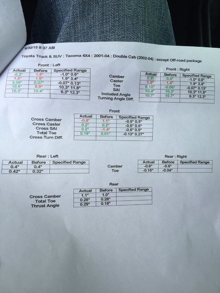

  12. Sep 30, 2015 at 12:51 PM
    Caligula
    Caligula Well-Known Member
    Sep 14, 2010
    #43228
    2,108
    Los Angeles, CA
    2000 Ext. Cab Prerunner 2.7L
    mmmmmm, not really. They didnt bother to align caster. It looks like they didnt even touch the right control arm. And I may be spending too much time on pavement, but there should never be positive caster on any car unless youre autocrossing. I would take it back and have it redone.
    A proper alignment has no more then a 0.1deg deviation from one side to the other.
    Also the left side of your rear axle is pushed back and lower compared to the right.
  13. Sep 30, 2015 at 1:09 PM
    tacomatrd22
    tacomatrd22 TRD SuperCharged Tacoma
    Sep 20, 2014
    #138725
    1,557
    Daniel
    Fort Smith, AR
    Supercharged tacoma
    FlowMaster Super 44 2" lift Gray wire Fog light
    I told them to adjust the camber and get it closest to 0, which they did and its a whole lot better than it was before. Keep in mind I put a 2" lift on my truck with stock UCA. And the steering wheel is right in the middle. And the rear left side of my axle might be lower because of my driver side lean, which will be fixed some other time next month.
  14. Sep 30, 2015 at 1:10 PM
    Squeaky Penguin
    Squeaky Penguin Nothing Ventured, Nothing Gained
    Apr 5, 2012
    #76340
    10,069
    Brett
    Steamboat Springs, Colorado
    '01 4WD, SR5, TRD & '13 TRDOR AC
    Lots of dust and custom dents, Check Build
    Most on here will disagree saying to max out positive caster. With 2" of lift and stock UCAs, you should be able to hit close to 2
    I've got 0 caster due to a bent spindle, and my truck doesn't track well and like to follow groves in the road etc.
  15. Sep 30, 2015 at 1:14 PM
    Caligula
    Sep 14, 2010
    #43228
    2,108
    Los Angeles, CA
    With a lift, you will have a lower caster angle, maybe slightly lower camber. It doesnt change the issue that they didnt adjust one side of your truck, and did not get close to matching the left and right sides. The front end has way to much deviation from one side to the other. And they did not attempt to get the toe near zero.
    Its your auto, so if youre happy then thats what matters, but im just saying i would never accept those specs with my truck.

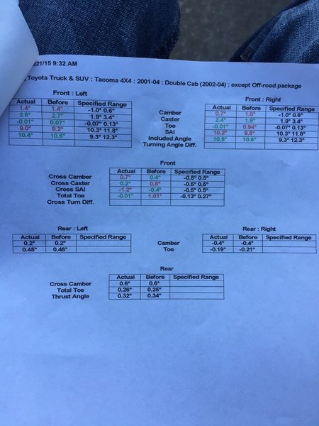

  16. Sep 30, 2015 at 1:19 PM
    tacomatrd22
    Sep 20, 2014
    #138725
    1,557
    Daniel
    Fort Smith, AR
    Supercharged tacoma
    My truck se
    Here are the papers from my first alignment with them. I might go back and tell them to adjust the toe close to 0 as well but time will tell.

  17. Sep 30, 2015 at 1:23 PM
    Caligula
    Sep 14, 2010
    #43228
    2,108
    Los Angeles, CA
    That front caster and toe looks like the autocross/track setup i have for my BMW M3 with a 1.5" drop. If you notice, they made the front camber worse after the alignment. If these are all from the same shop, then cut your losses and go somewhere else.
    Here is what i would recommend for a street truck:
    https://www.tacomaworld.com/threads...-proper-alignment.381518/page-2#post-10492783
    Camber: -0.4 to -0.6 each
    Toe: 0.05 to 0.10 (0.10 to 0.20 total)
    Caster: 2.0 each or more
    No more than 0.1 left to right deviation on adjustable components.

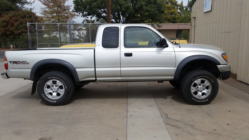

  18. Sep 30, 2015 at 1:31 PM
    TACO TX
    TACO TX Well-Known Member
    Sep 29, 2012
    #87962
    2,309
    Kelly
    Denison ,Texas
    2017 DC TRD Off Road 4x4(Barcelona red)
    Weather tech liners, Ranch Sierra truck cap
    It's definitely nose high. :bikewheelie2:
  19. Sep 30, 2015 at 1:39 PM
    tacomatrd22
    Sep 20, 2014
    #138725
    1,557
    Daniel
    Fort Smith, AR
    Supercharged tacoma
    This was the first alignment after my lift last monday, I came in today and got it realigned and the first post you quoted about was from that. The only alignment they did last time was the toe and go, I watched really closely this time.
  20. Sep 30, 2015 at 1:47 PM
    Blackdawg
    Blackdawg Dr. Frankenstein
    Dec 31, 2010
    #48500
    81,616

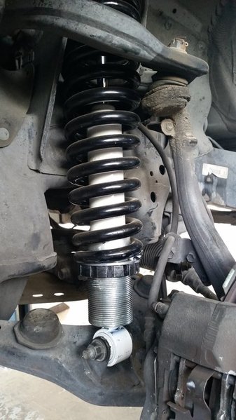

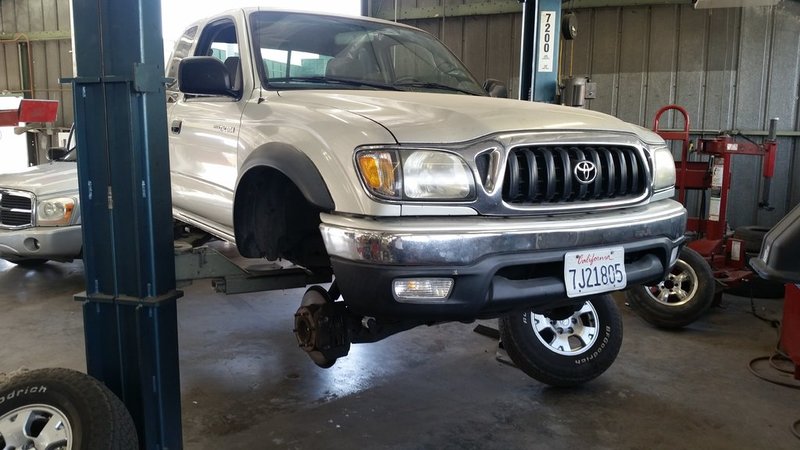

    Monte
    Wyoming/St. Louis
    The Trifecta of Taco's
    Dude your CVs and Ball joints are screaming and i can hear them from here.
    lower the front. WAY too high.
    You have 0 down travel i bet.
