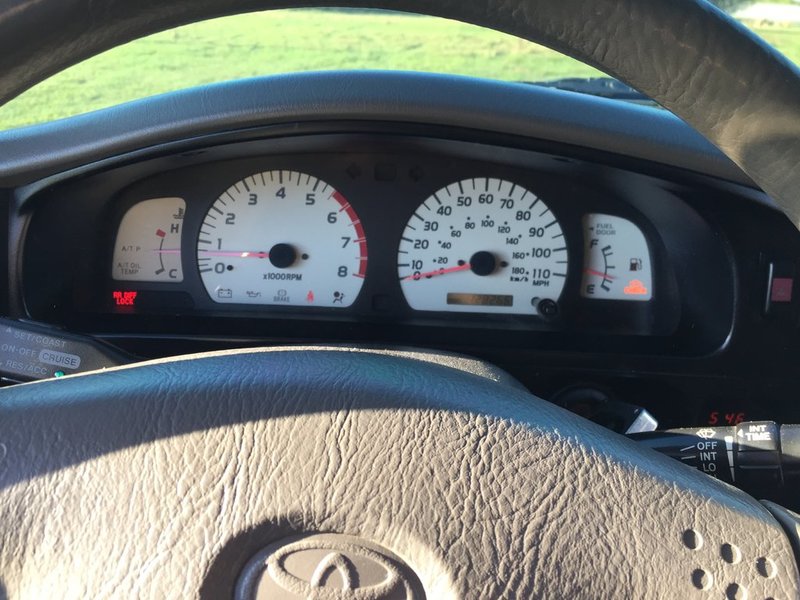

    Did yours drive fine other wise? It's shifts really good and smooth.

    Dad drove it, he could feel it rocking just a little too much in park. And i mean you could stand outside the truck and tell it has a hard engagement. The rear end feels likes its try to jump off the ground( at times). Dad felt the same.
    Since we did have everything apart, we thought the kickdown cable (think that is the name???) wasn't adjusted properly, so we tried adjusting it either way, didn't make a difference.
