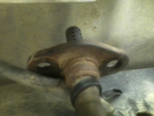

    Here is my O2 sensor:

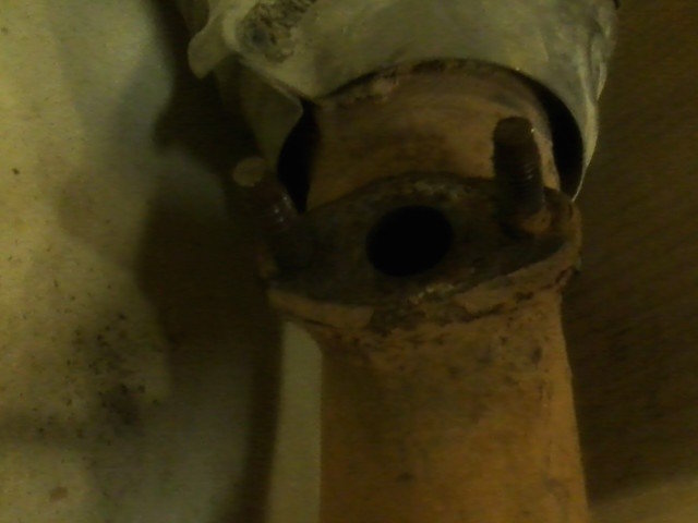

    It needs to be nutted on to a couple studs. This is what the piece I need looks like:
    Preferably in stainless to match my new exhaust.

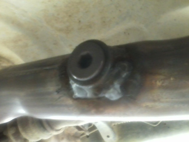

    Here is what the guy put on for me:
    He misunderstood that I wanted to re-use my stock sensor and put on a mount for the universal sensor. I've read that the universal won't work with the stock/denso front sensor.
    He doesn't know where to find the mount that I'm looking for so told me to find it and bring it to him and he'd mount that for me instead!
    Any/all help appreciated! I've done a bit of searching myself but come up short so far..

  14. Oct 2, 2015 at 11:02 AM

    I have the same sensor as you. Don't have a pic on my phone. Call cxracing.com. they have them for relatively inexpensive. I couldn't find a link on their website. They have complete turbo kits for our trucks. (5vzfe). You just need to bolt yours to the new flange after its been welded.

    Ahhh that makes sense. Thank you guys for the help! I'll order one in stainless and bolt it all up.

    The Bosch and NGK brand a/f sensors so have a threaded body that you screw the oval mounting plate onto, just like a old school O2 sensor. They are not the OEM DENSO unit, but its worth taking a look at if youre set on using the round mounting.
