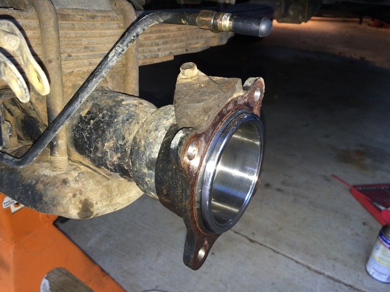

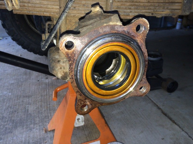

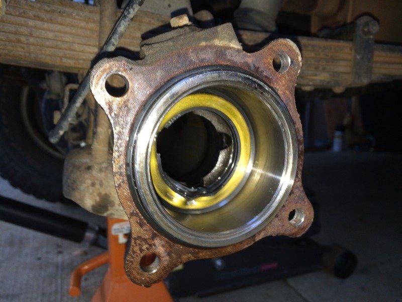

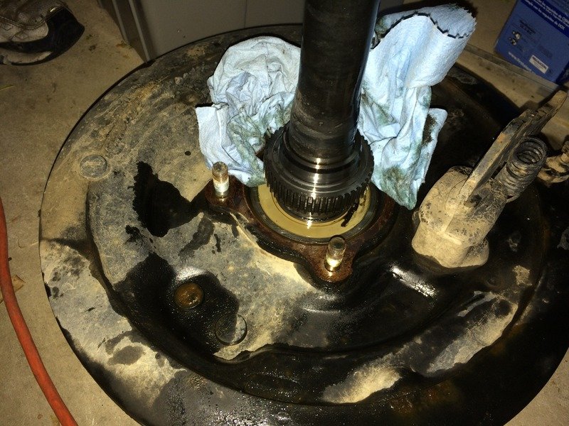

    My truck got another leaky rear seal, replaced the other one years ago so the other side was due to die at some point lol. Last time we went through like 4 seals because they don't have to greatest design to install and they kept bending. This time to make it easier we ordered this: http://www.lowrangeoffroad.com/special-fit-eco-seal.html
    Now I'm a bit confused, anyone have experience with these? It says it fits my truck but it won't go past the outer edge of the axle housing. Of course Low Range is closed today for an event so couldn't call them.

    What do you mean wont go past housing? Says in description the outer lip sits flush with housing. Also that it wont fit if you have ABS if you do

    My old one sits about 3 inches down inside the housing. I don't see where it says the outer lip sits flush with the housing, all I see is that the seal sits parallel with the housing, like my old one did as well. I don't have ABS but you can see that it has the ABS gear on the axle, and it came that way from the factory.
    Old seal
    No ABS
    You can see it has the gear for the ABS
    This is as far as the new seal goes, you can see the old seal still in the back.
    We used one last time and it still got all fubarred lol

    Looks like your truck has the abs housing and gear and its just been plugged. Ive seen a non abs one before and the seal sat flush and no gear on the axle. It was 2.7 4x4.

    The new seal is SUPPOSED to be flush with the lip of the housing. The 'old seal' (3-inches into the housing) was INSTALLED INCORRECTLY. No wonder ICEHORSE has been having problems.

    Looks like you have an abs axle, my seal sits flush with the edge. Didn't you get a new/replacement axle a while back?

    I think hers does ride inside, I don't see how a seal will get over that abs gear.
    Mine rides on the edge, and seals against the largest portion of the shaft, near the bearing.
    Even though her truck is non abs, the axle is. She has the wrong seal for that axle, I'm guessing..:notsure:

    I was thinking the same thing but I never changed one. And her axle housing looks like a capped off ABS axle housing. So she might need a seal for a ABS shaft. I don't know if they are different.
