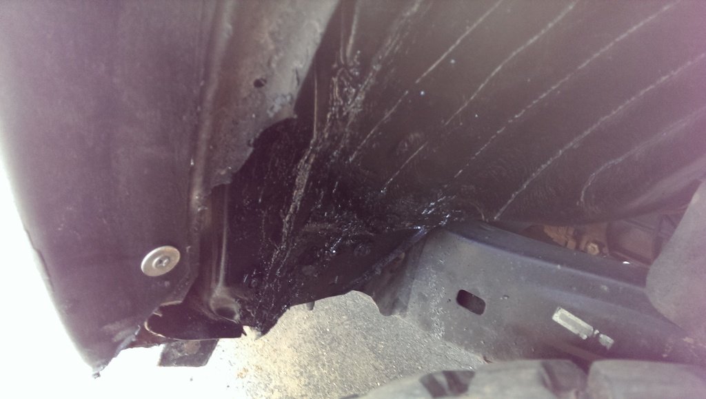

    With my stock UCA, I couldn't turn the wheel much more than a 1/4 turn before I was rubbing very hard on the inner fender well, hence the need to go with an aftermarket setup.

    When increasing castor by using the LCA cams, you move the bottom of the spindle forward, and increase firewall clearance. By increasing castor using UCAs, you move the top of the spindle back, decreasing clearance to the firewall. It doesn't make sense that you rubbed the firewall with stock UCAs and not with the LR, but I'm guessing it has to do with the overall alignment of the LCA cams and the rubbing your talking about at ride height.
    See above. More castor does not always equal more clearance.
    I run 295/75s, stock UCAs, and currently have 0* castor. I've cut off the entirety of the pinch weld, and hammered the firewall back a couple inches. If were to install aftermarket UCAs today, I would most likely have to tub.
