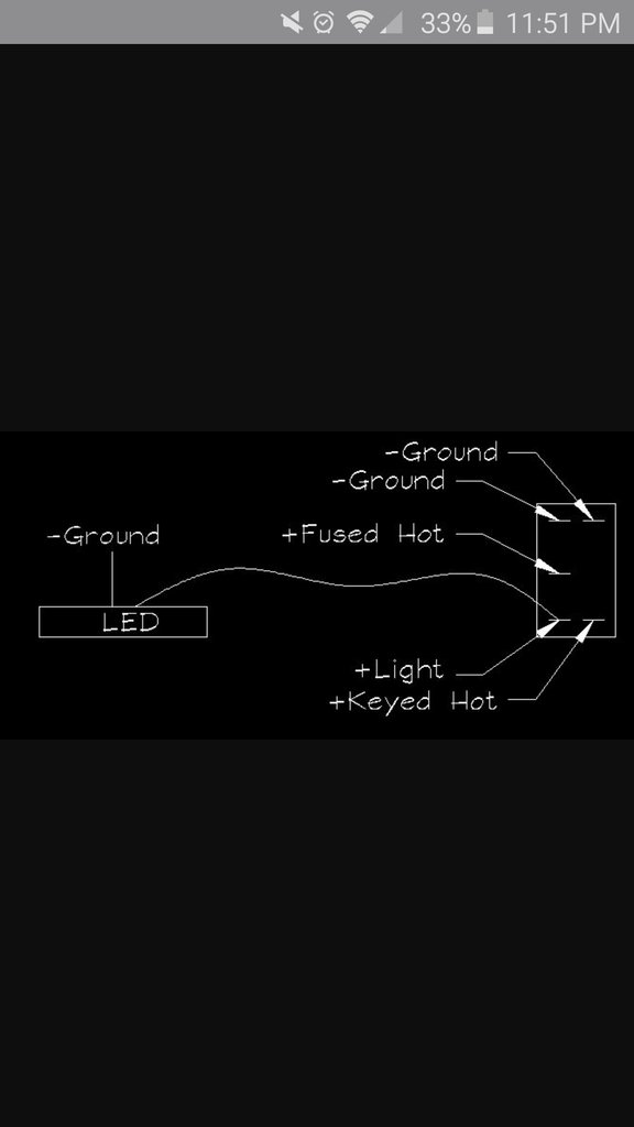

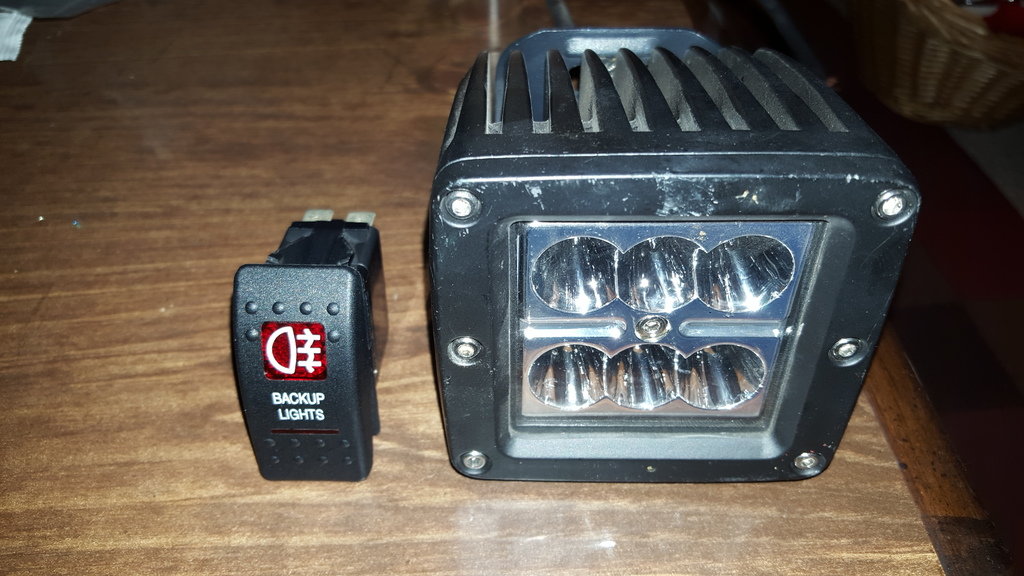

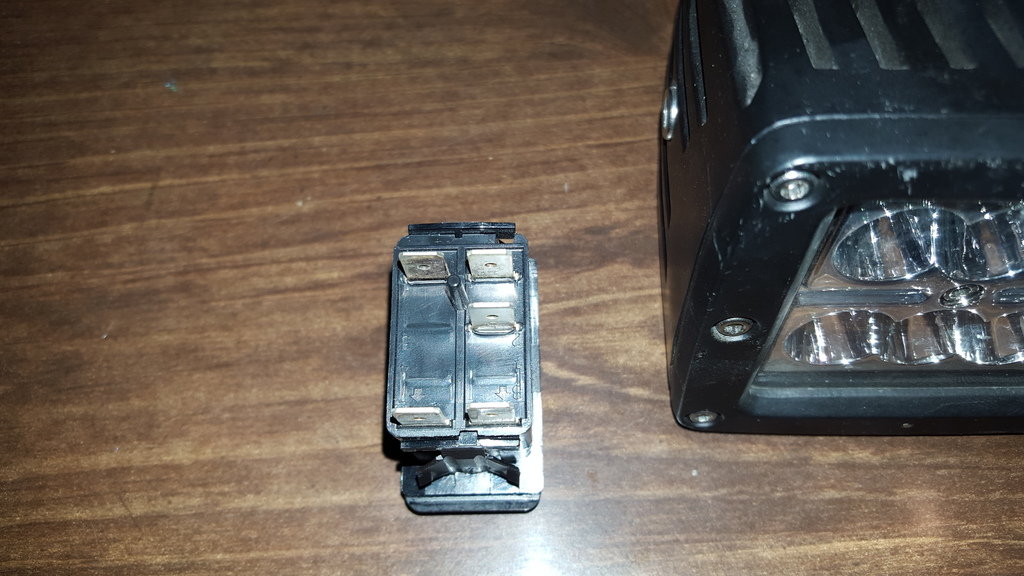

    I'm gonna clog this thread with more questions because making a thread just for this seems like a waste.
    I want to wire up two of these lights to this switch.
    20151016_000243_zps33rnkb4y_63fc08b76a77cfa662fd7fdf5b9112d2f8d5cc07.jpg 20151016_000304_zpsrt0o4ftg_2928d4694e455766f28ad62e558e1a7f374d8d9e.jpg
    My question is can I set this up so both LED's in the switch light up when its on?
    I dont really need them to come on with the head lights.

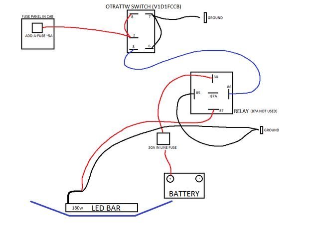

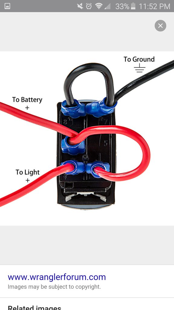

    Also do I need to use a relay? I understand the purpose of one but is it really necessary?
    Screenshot_2015-10-15-23-51-58_zpsjj7ci7_578dfe82ea75c974399d2c58b189da1bc454088f.jpg Screenshot_2015-10-15-23-52-39_zpscaolwn_e810b8efc396e7aa8e539feacb649c6adaa82b17.jpg 0m65zQ8l_zpsgjn8xipt_c3b64c65bc7687bc11b6b15a0c64d53de40bf48e.jpg
    Ive found 3 different diagrams so I'm almost more confused than when I started.

    First one is how you'd wire if you wanted the independent light to turn on with the headlights. The last one doesn't make sense to me or is for a different switch. This one would work, but the independent light will be on whenever the switch has power. The way they picture that wired 'to battery' the independent light would be on all the time. If I were you and didn't care about lights, I'd just ditch the independent side and don't wire those two prongs, dependent light will still light up when on. Also, if all you're doing is wiring in 18w pods. You'd be fine running that through the switch without a relay, but a relay couldn't hurt.
