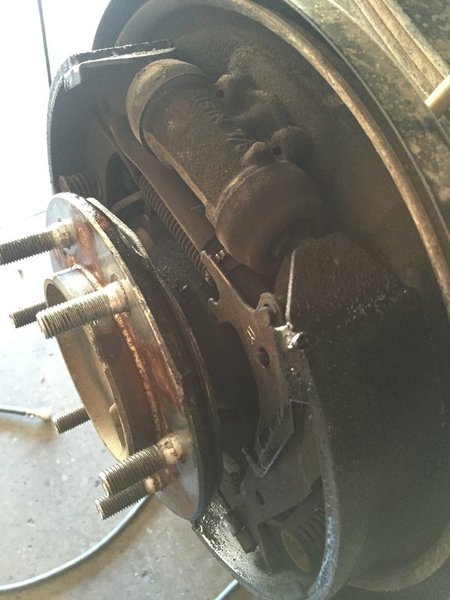

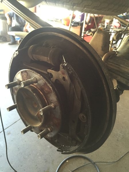

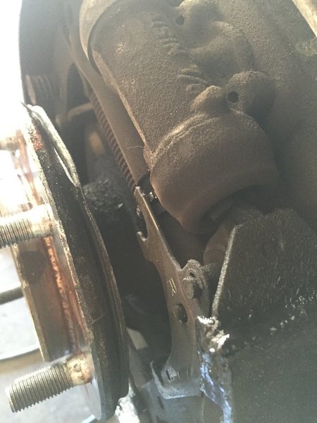

    Hard to tell from the pics where it's leaking but a bad bearing will eat the seal. It's a terrible
    Job because the bearing needs to be cut off and pressed on. I would advise you to pull the shaft and take it to a bearing and machine shop to pop the new one on. Other than the bearing it's as simple as the four nuts on the back and disconnecting the brake line. The deal however is straight forward.

    I actually watched a video over this, it's real easy once you and the video described it. And I will take it to a bearing machine shop just like you said. Thank you very much this is going to be cheaper project than I thought.
