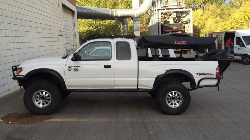

    i cleaned up my ratty rims :D

    beautiful truck!

    That roof rack tho :drool:

    Damn you have a DC..... if you had a Xtra cab you could get one now

    thanks buddy!!
    i couldn't be happier with it, id strongly suggest picking one up.

    Roof rack? where?

    its located on the roof. :D

    What type of rack is that?
