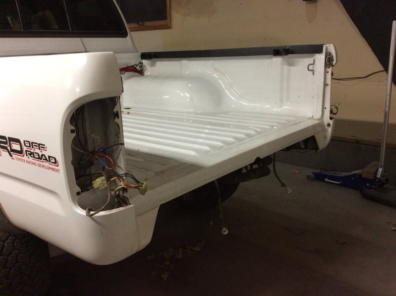

    Few minor things tonight. Few parts off the bed. Cleaned up the frame mounts, and used the rattle can to paint all that white area black.image.jpgimage.jpgimage.jpg
