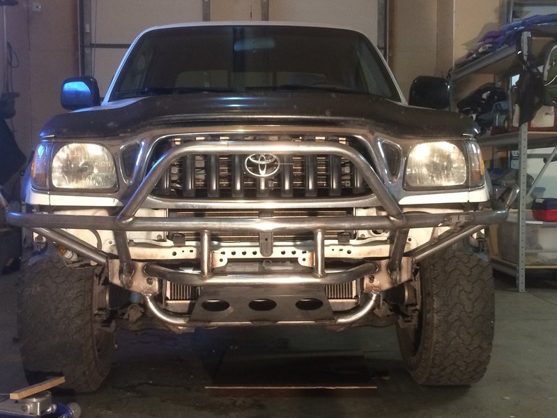

    Is my imagination or is the radiator more exposed /visible with this bumper? Does paint and option or later project?

  13. Nov 4, 2015 at 12:12 PM
    allpro
    allpro Well-Known Member
    Oct 17, 2008
    #10025
    1,689
    Montana
    All Kinds Of Toyotas!!!
    The bumper @-40 has will run you $549.00 (bare/unpainted) If you have a 98-00 you'll need to add Frame Insert Adapter Plates for an additional $19/pair. :thumbsup:

    Not sure if you're asking me or him... but mine was like $850-$900 after shipping and powdercoating
    2002Tacoma4x4 likes this.

    Definitely is... But higher airflow! lol
    2002Tacoma4x4[QUOTED] likes this.
