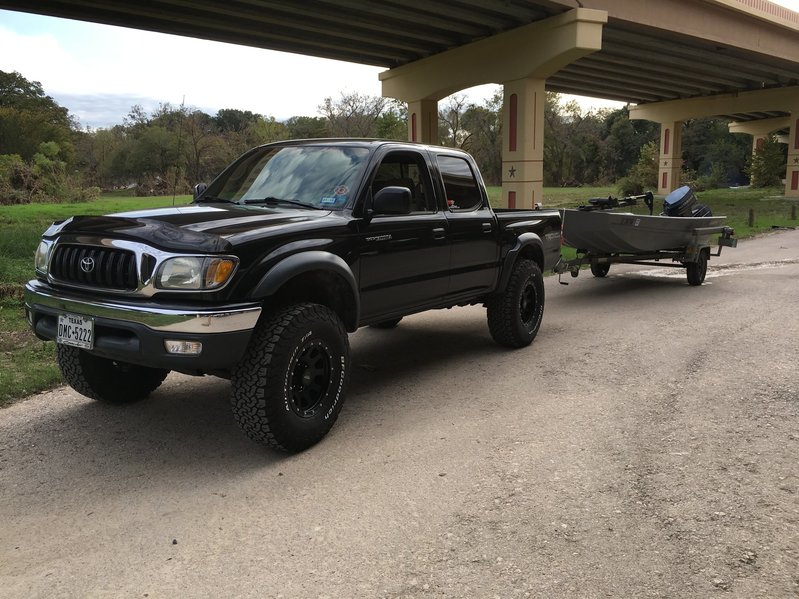

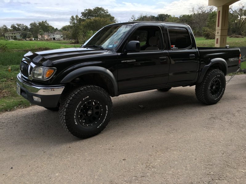

    Got her some new wheels and ko2's and went fishing.

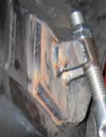

    Here is a little tip for the limit strap mounts. I did some thing like this. I cut some 3/16 plate and welded the mounts to it, then welded the plate to the frame. Like the pic below. But I didn't make the plate as big as it is in the pic. The plate was just big enough to weld the mounts to and have a little meat to weld to the frame. It's up to you.

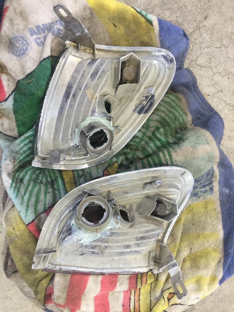

    Relocated my turn signals. Was very liberal with the epoxy not so much for sealing but hopefully for strength since you need a decent amount of pressure to put the bulbs in.

    How all limit straps should be welded

    Good to know. I just stumbled on the idea because my vertical isn't very good. Plus using a sick to get in-between that mount vertically would of kicked my ass. At least it know welding flat first I can get good welds on the mount.

    Vertical is a bitch (7018 anyway), especially in a position like that.

    Yup. Thats what I'm using.

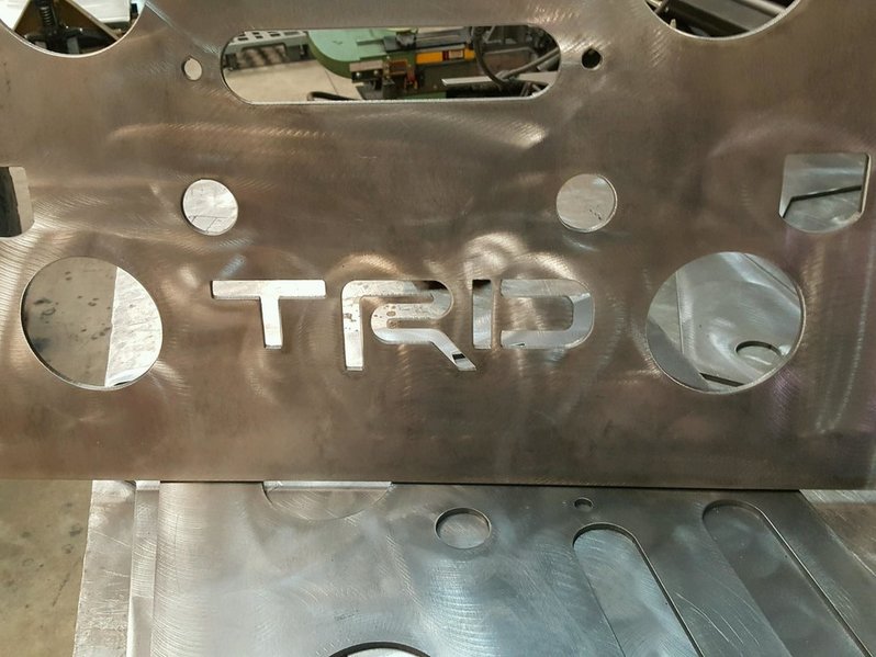

    Eric sent me a pic of one of the pieces of my bumper after being cut
