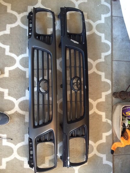

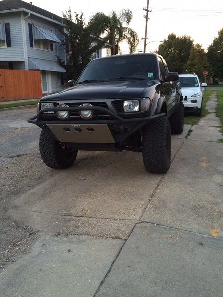

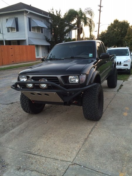

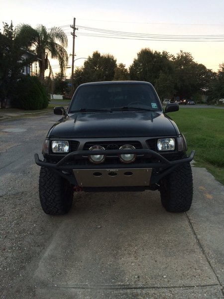

    Noticed my grill was chipping badly. I painted it black over the chrome about 3 years ago and it has held up pretty well until now. It looks terrible. I decided to get a "grey" grill that I found on eBay. I saw it on another members truck and it looked good. I also liked that I wouldn't have to paint it or worry about it chipping. Installed the grill today and it looks awesome. Goes really well with the black, and also my aluminum skid on my bumper.
    It also came with some corners but I didn't have time to do the blinker re locate mod before work. Gonna get the corners swapped out next day I'm off.
    Sorry if the photos are too big. :oops:

    That looks really good. :thumbsup:

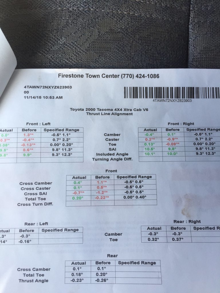

    Here's my alignment specs. Just got lifetime warranty form Firestone
