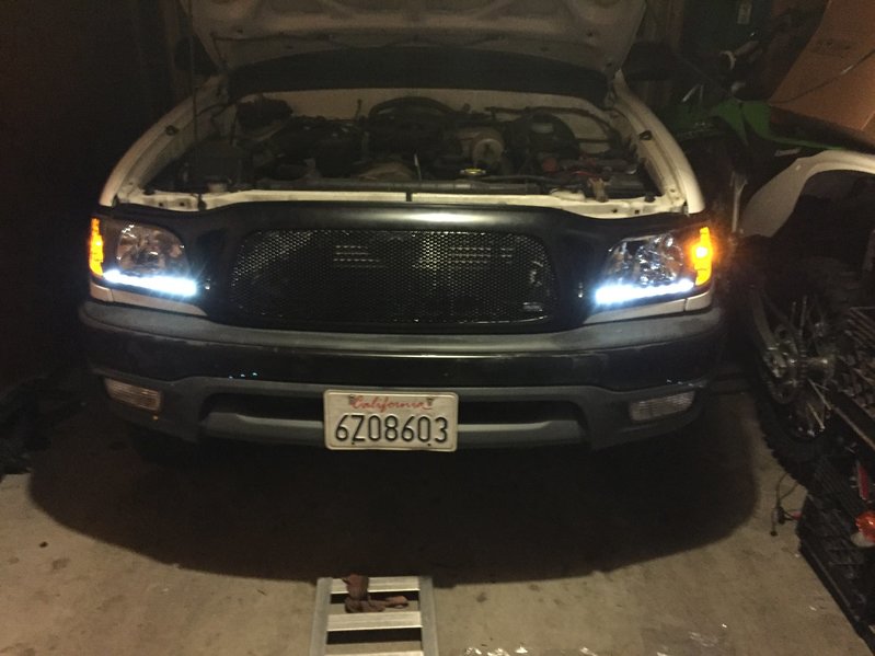

    Scrapped the chrome grill for a black one put a grillcraft Mesh insert.
    went with new headlights and corners.

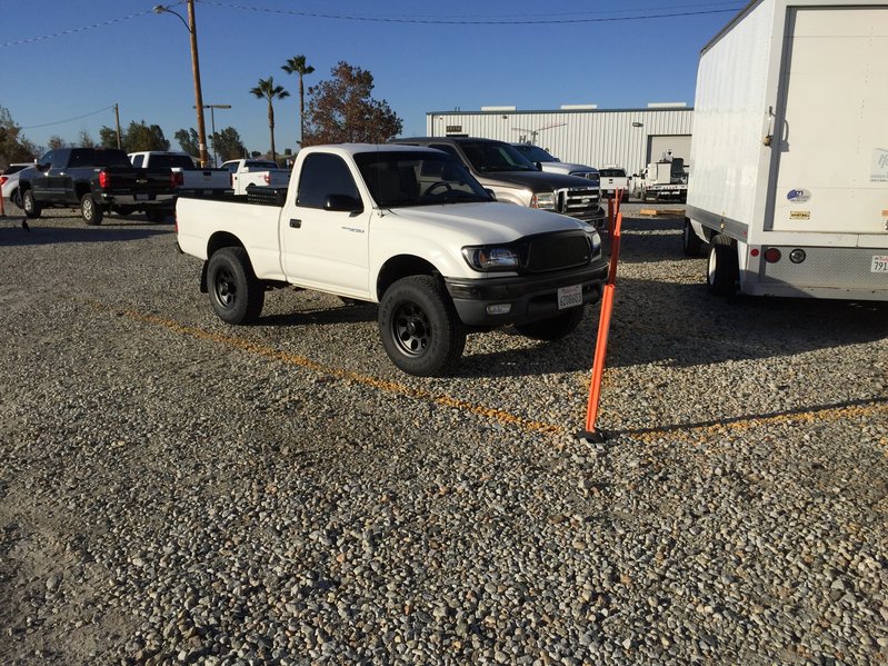

    No sir, no bro lean here....or maybe I just haven't noticed. I'll look tomorrow, I feel like I'm dying right now. Damn cold
    Shoot, I might just go back this weekend. Lets work those free alignments! Lol
    I appreciate the feedback gents.....I'll chime in once I get this all squared away

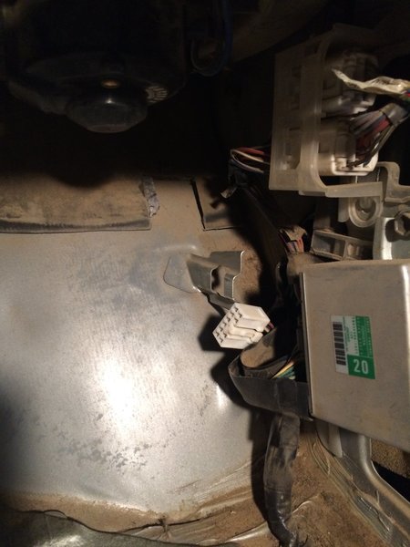

    Install this a couple of days ago.

    Does the ADD relay plug into this plug?
