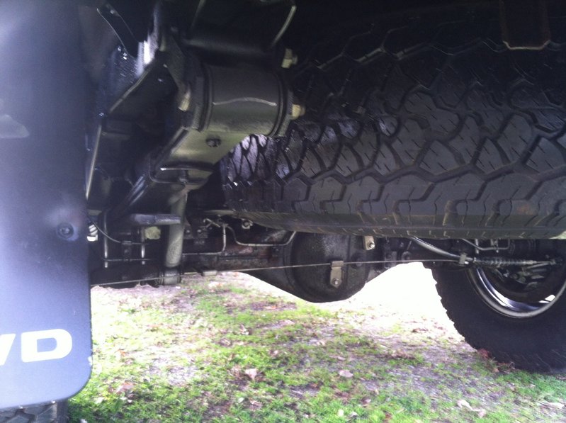

    loving the 882 coils. liking the sway bar removed. thanks to all who helped with information and advice.

    Your spring seat appears to be upside down.

    You're right. Good eye.

    ugh.. yes great eye.. like that on both sides. guess go back and tell them to flip it.

    It will probably change your lift height some too, so if you had an alignment done, you'll need another.

    no alignment done yet. drives straight. I called the shop and emailed them pictures guess they will be flipping them. thanks man

    getting fixed this afternoon.

    she getting fixed as I write this. thank you for pointing this out. it's great how helpful everyone has been on this site. glad there is guys like you and many others on here willing to help people like myself out. still learning about the Tacoma and would have never knew about this. thank you.
