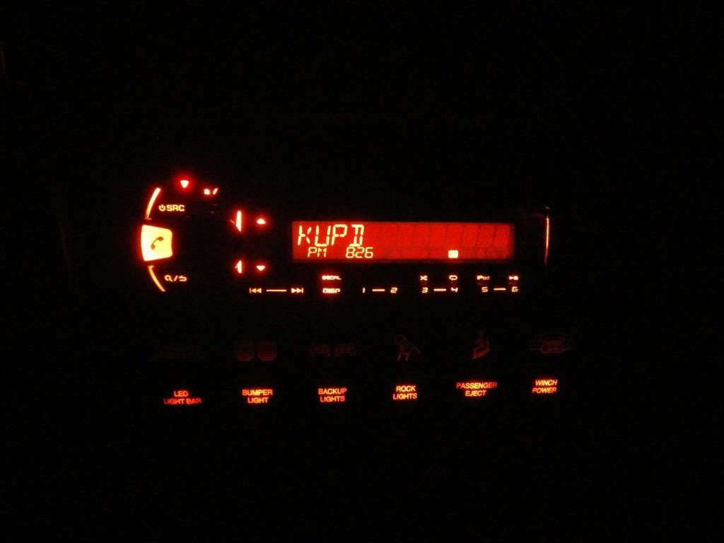

    Ha what about it?

    Ha thanks! When I put all of it in I was surprised on how well everything looked. Still need to fine tune everything to fit nicely.

    Just wired two of mine up! I can't help but keep switching the lights on and off for no reason just because it feels so awesome to flip these switches

    Hahaha its definitely something ive thought of doing!!

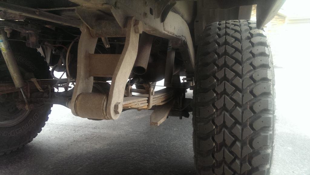

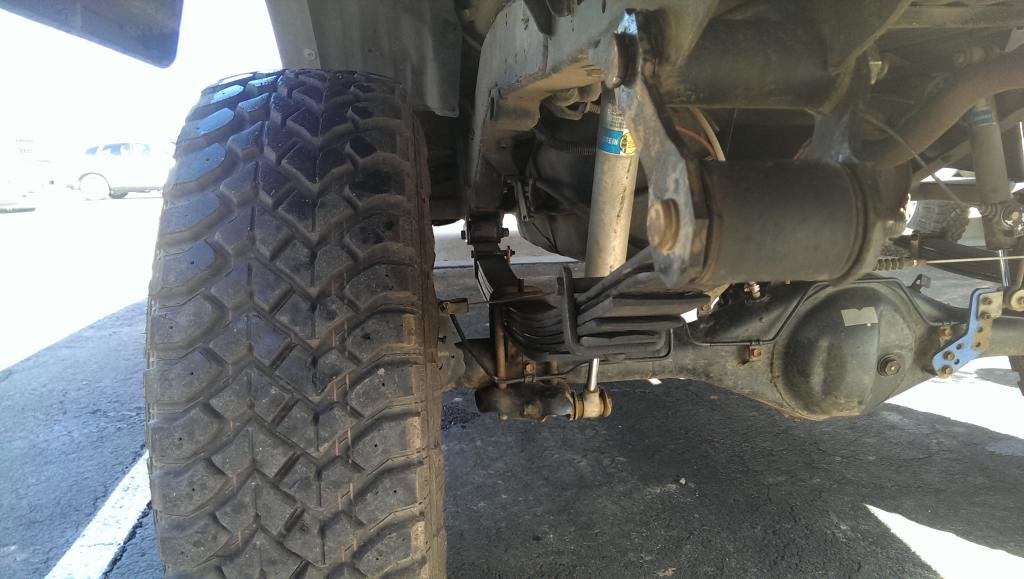

    Probably cheaper actually. I picked up a set of leafs off a '91 S-10 from a pick and pull for $44. Then built an awesome set of leafs with a lot of help from @BDN.
    Went from this mess:
    To this:

    Thanks man, I will be playing with them when they're installed :D for an hour :rofl: glad you like your setup. Got a picture?

    Man. That looks a lot better. What leafs did you switch out? I was thinking of switching out the second leaf and seeing if I could keep my 3 leaf AAL.

    Well, that was not an OEM leaf pack I started with. It was an Alcan (Wheeler's 5 pack plus AAL). Have 3 alcan leafs and 3 chevy leafs. It's not an exact science. If I were starting with Toyota leafs though, I would want to ditch as many of those as possible.

    @chowwwww Brett leaf pack he made looks awesome in person. If I wasn't going long travel I would do what he did.
