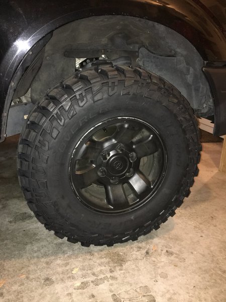

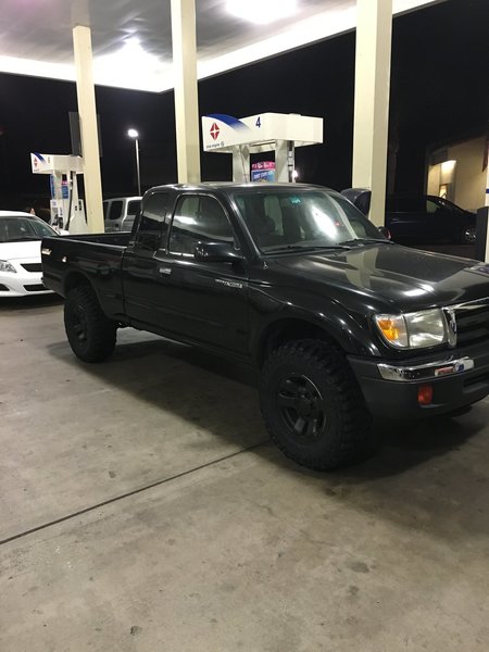

    Recently put on new tires today cooper discoverer stt pro's

    Jesus. Another st variation. Cooper needs a new name for tires sheesh
    Chipskip likes this.
  13. Nov 20, 2015 at 11:40 PM
    pittim
    pittim mittip backwards
    May 28, 2008
    #6939
    18,975
    Pennsyltucky
    Boujee Prius
    It’sa Lexus, boogie woogie woogie
    They don't make the STT anymore and it was replaced by the STTPro.
    But yea..ST, ST Maxx, STT, STT Pro.
    They like Ss and Ts

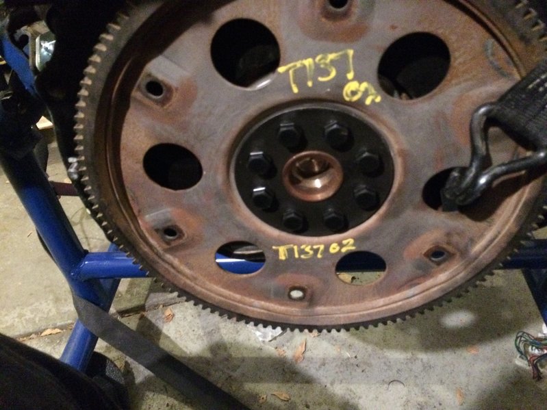

    Thread locker recommendations for these flex plate bolts. Red or blue. I'm thinking red. @BDN , @Blackdawg
  16. Nov 21, 2015 at 6:04 AM
    Deathbysnusnu
    Deathbysnusnu Work is just a daily detour to happy hour.
    Oct 4, 2013
    #113825
    17,367
    Brett
    Fort Crawlins, CO
    Vintage Tundra
    Dog, camper.
    Blue if anything but the torque value should be enough as is.
    I've never used Loctite on a flexplate or flywheel before.
    See what @Blackdawg says.
    Chipskip and SilverGhost[QUOTED] like this.
  17. Nov 21, 2015 at 6:17 AM
    Blackdawg
    Blackdawg Dr. Frankenstein
    Dec 31, 2010
    #48500
    81,652
    Monte
    Wyoming/St. Louis
    The Trifecta of Taco's
    Red. Do you really want a fly wheel bolt coming loose?? No. Toyota uses red from the factory. Yea it's a bit harder to break the bolts free but...that's a good thing in this situation
  18. Nov 21, 2015 at 7:08 AM
    chowwwww
    chowwwww Well-Known Member
    Jun 9, 2014
    #131583
    1,932
    Orange County
    03 Doublecab 4x4
    Billys 5100/Eibach and Wheelers Progressive 1.5 AAL with overload in
    I use to use red on my old manual.
    SilverGhost[QUOTED] likes this.
  19. Nov 21, 2015 at 7:59 AM
    LSC15
    LSC15 Southern Retrofits
    Feb 13, 2013
    #97458
    7,043
    Logan
    2008 TRD D-Cab
    2008 Double Cab - Current 2002 4runner - Sold 2001 Double Cab - Sold 1995 Xtra Cab - Sold
    I used red in my old truck

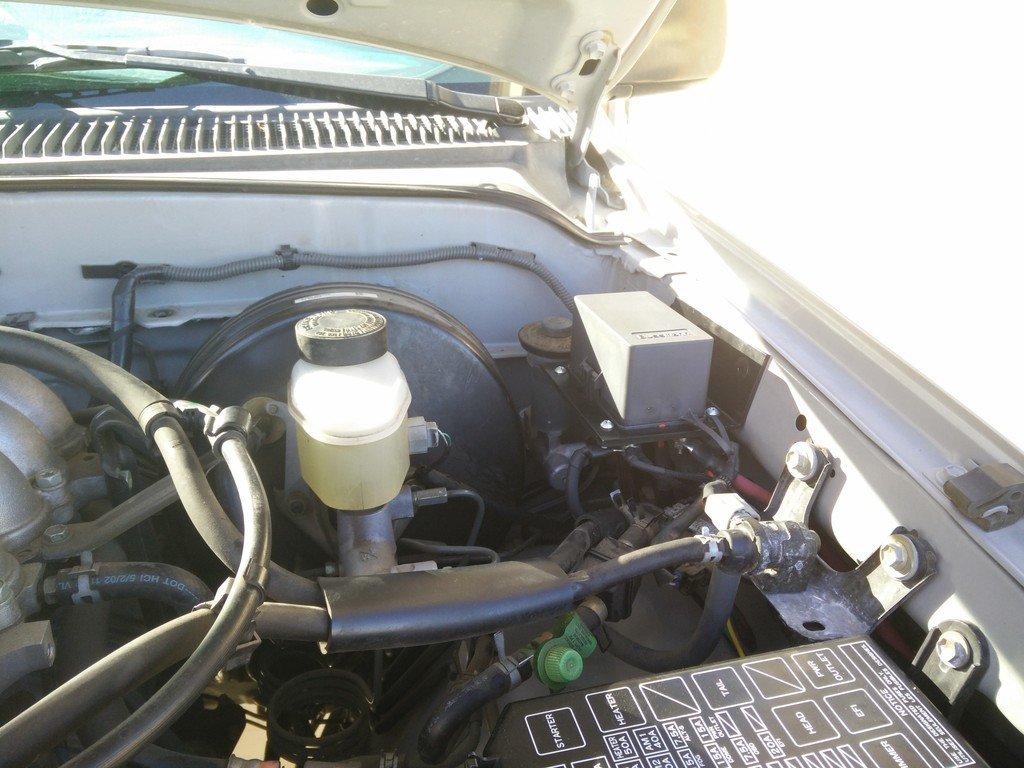

    Finally got the aux fuse box installed!
