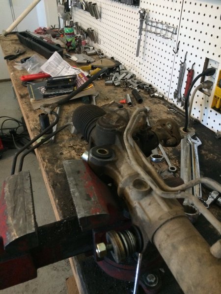

    I got a few things done today.

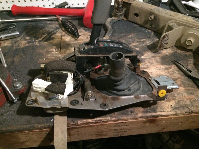

    I got lucky. The transfer case came with a boot for the shifter. So I removed the one i cut and installed the right one.
    I replaced the steering rack bushings that I got from wheelers off road. Thanks @BDN I used a bolt and washers to press the sleeves in.
    The nuts are not tighten down on the tie rods yet because I still have to take some measurements when I put the rotors back on.

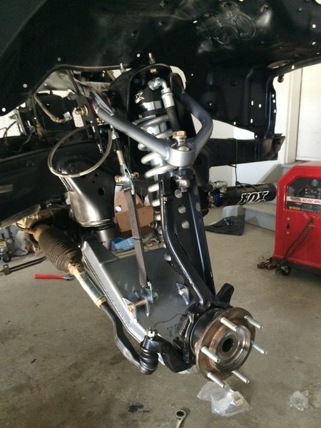

    I replaced the old outer tie rods with new OEM ones. I Had to put the Tie rods on left on the right and right on the left because of the curve in the tie rod to be facing away from the secondary shock mounts on the LCA. I also added the TC extensions for the tie rod. I added the steel brake lines.

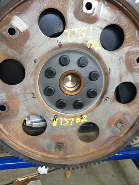

    The right spacers came in for the drive plate. There are two of them one between the plate and block and the other on back. I used red lock tight and torqued them down to 61 lb ft is a star pattern.
