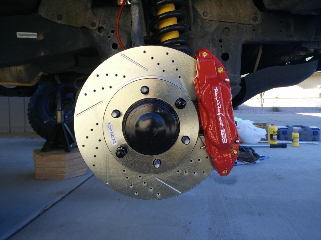

    This is how my passenger side looked

    Yeah exactly the slots and holes should curve towards the rear of the truck!

    Perfect! thanks for posting that pic.:thumbsup: That's how I was thinking too, so the rotation pushes the debris to the outer edge.
