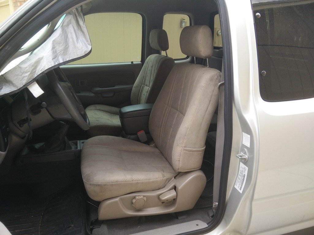

    Edit: This is what they look like

    Yep. I think that's what I'm looking for. Thanks. How much fabbing did you have to do to make them work? Thanks. I've found a set for $150 close by but don't know what they look like.
  11. Nov 24, 2015 at 10:05 PM
    T@codawg
    T@codawg Well-Known Member
    May 9, 2015
    #154955
    111
    Mark
    Nashville
    99 TRD PreRunner Xtra Cab
    Full OME 881's w/nitros & Dakar leafs in rear
    Did you have to fab the tracks or move the anchor points or any other fabrication?
  12. Nov 24, 2015 at 10:14 PM
    Delta00
    Delta00 ᕕ( ᐛ )ᕗ
    Sep 16, 2013
    #112633
    4,137
    Troy
    Chandler AZ
    2002 Toyota Tacoma 4WD
    Check Build
    I just swapped the rails from my Tacoma seats to the 4runner ones. Which is a lot easier said than done. Lots of drilling and grinding to get it to work. Took me about a day to figure out how to get the rails off, then another day to figure out how to get them on the 4runner seats.
