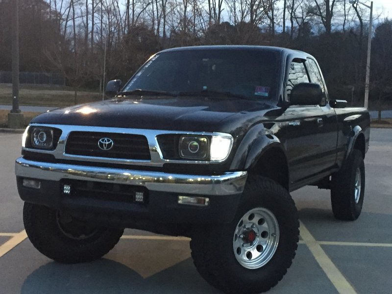

    What bulb type do have in the sidemarkers? They look really bright I like it.

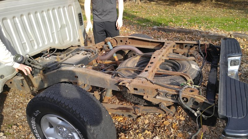

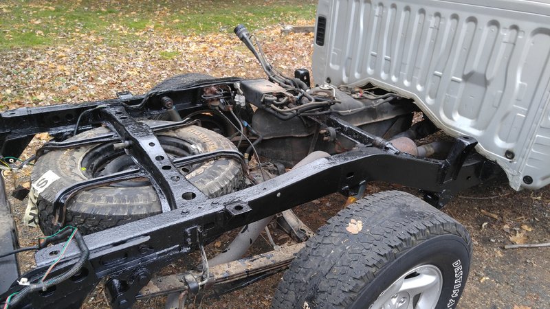

    Technically yesterday, but with some help, I got a chance to get the bed off and coat the frame. I'll see how it holds up, but the KBS 3 step system seems to be well worth the money. To not spam pictures, here's a before and after. This weather was a godsend. I thought I'd go unable to get it done before my first Winter with the truck.
    Then today I took care of the inside of the boxed section with the Eastwood internal coater. Odd application. Not doubting it works, but just a little doubt in my application. But even a sub-par application should be better than none at all.
    Waiting on a few parts from Toyota. Should be in tomorrow. Main part is the fuel pump gasket. I believe that's the cause of the wetness on the tank/fuel smell as well as the now-gone-for-some-reason CEL code. So until tomorrow, the truck's still apart. Oh and I cleaned off the back of the cab and front of the bed. It's impressive how dirty they get.

    Looks good, did you wire wheel any of it? Or use a needle scaler? Also did you tap around and check for firmness?

    Yeah they are all pretty bad, but the rears are awful. Especially that passenger side. Not only are the tires past due, but the PO had them inflated to 40PSI all around, so the centers are basically smooth. I have new tires on the way. Should be here today or tomorrow. But due to bed off, I'll get them put on tomorrow either way.
    It's a rattle can with a thin, flexible/maneuverable hose that hooks on to the top. Then you put it inside access/drainage holes in the frame and blindly spray away.
    Not quite a wire wheel, but a thick wire brush attachment for a drill, as well as 320 grit sandpaper (per KBS instructions). Yeah I've already gone up and down the frame with a hammer. Once before buying and once since.

    Just some LED 194s from Super Bright LEDs. They are brighter than stock but the picture makes them look a lot brighter than they are

    My tires looked the exact same way lol, and they got me from western Washington to wyoming:anonymous:..I have to get off my lazy ass and do that to my frame before I ship her to Hawaii. Cancer happens at grossly accelerated rates there..just pick a hole, hit the trigger, and flop the hose around ey?:rofl: sounds like a good time..where did you buy the stuff? Online or parts store?

    It's too easy to put things off. I'm making a point of not doing so with this vehicle. I'd have gotten tires already, but funds aren't there because, ya know, just bought a truck. But at least I will appreciate the feel of new tires, since these ones are so bad. But you gotta get new tires! Assuming you've got the funds, get on it ASAP. It puts you and others at risk by driving around on wasted tires.
    Not surprised. The whole state is islands, and none are overly large. Chances are, you'll be near salty sea air. That's arguably worse than snow/salt/brine in Winter because you can't just wash it off to help avoid damage.
    Yeah basically. The idea is to stick the hose in a bit and then spray as you pull it out. I got it online. I believe Amazon.

    Oh ok ya I have the 194 5smd ones in there too.

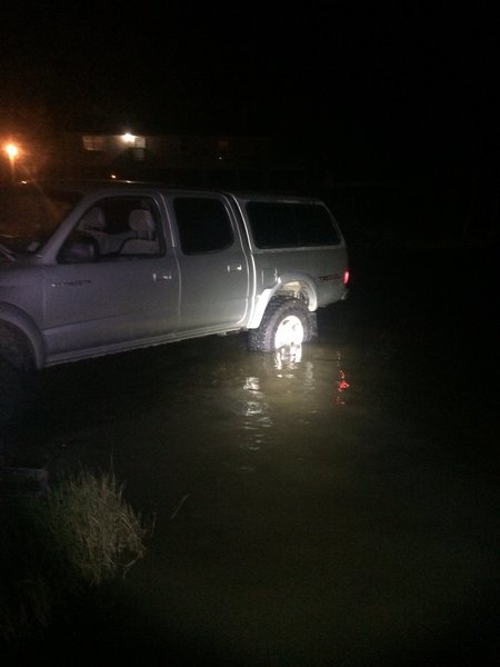

    Last night I had to drive my truck into water that was ~1 foot deep to jump a tractor, after that I went and drove the streets to see which ones were flooded from the high tide, deepest water I found was ~18".
