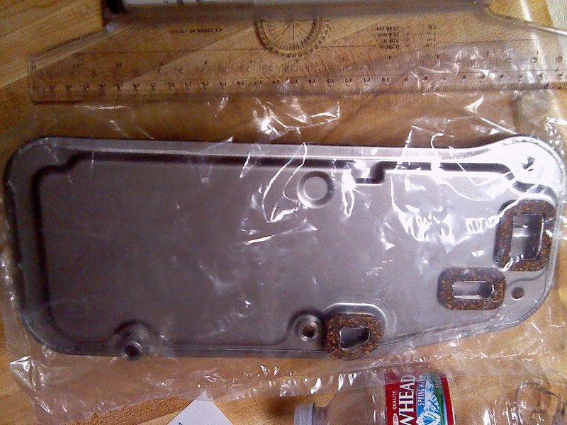

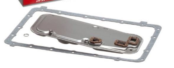

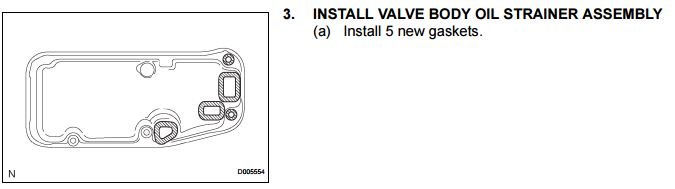

    My A340E was drained and filled at 60k, everything is still working fine at 120k miles and I'm now doing a service. I have the ATP B-211 filter kit, confirmed correct for this unit. The service manual CLEARLY shows the strainer needs 5 gaskets but I got only 3. The missing gaskets are around 2 of the mounting bolt holes. Are these gaskets necessary? The 3 larger holes for fluid transfer have the cork gaskets there, and all the pics I can find do not show the other 2 gaskets around the mounting holes.
    Also there's no drain plug washer as indicated in the photos for this kit. Can I re-use the drain plug washer? Now considering that I may have an incomplete kit.
    Here's a pic from the service manual:
    Here's the filter I got:A340E filter 1.jpg
    And here are snippets from the internet showing this filter kit:

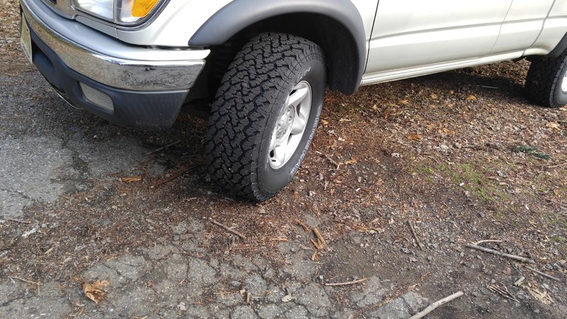

    Yesterday, I put got some buddies from work to help put the bed back on, then I got new tires.
    Here are the new ones:
    And to get an idea of how badly I needed new ones, here's a shot of the old ones:

    Check out my thread on this, I just did this and faced some confusion with finding the proper filter kit.
    https://www.tacomaworld.com/threads/psa-the-correct-a-t-filter-kit-for-your-tacoma.405898/
    Make sure your tranny is not a 30-40le model. It's interchangeable with the A340E but has a different filter.
    But what truck is this for? Shouldn't you be asking in the 2nd Gen forum?
