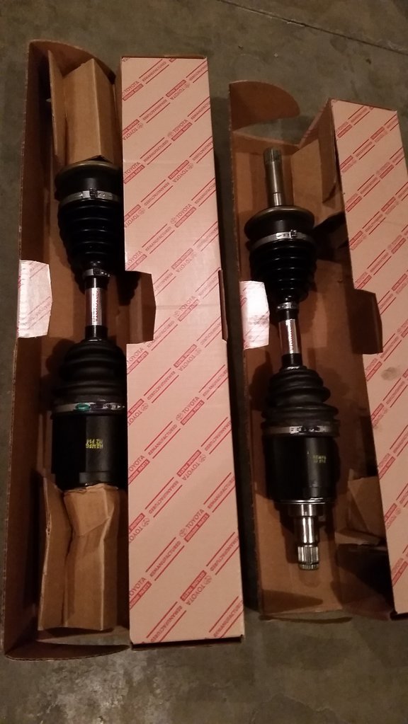

    Awww yeah bishes :D

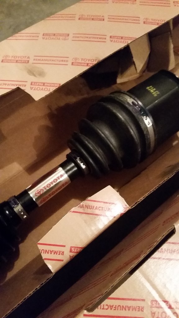

    Shiny new CV's! Nice

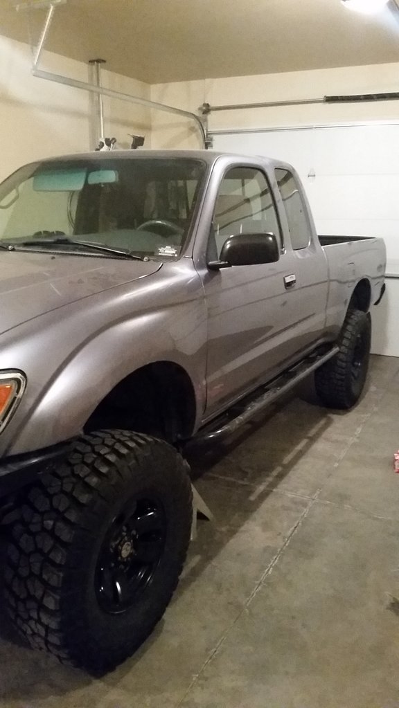

    Now its time for a winch and lights.
    No way, not going to black it all out

    Even though my truck is on jackstands, I still love coming over to my dads house and seeing this :drool:

    No your not, I will keep the chrome grill, door handles and lug nuts

    I have chrome powered mirrors, if you have black I'd be willing to swap. I like chrome, just not on my truck.

    Wow, bet that wasn't cheap!

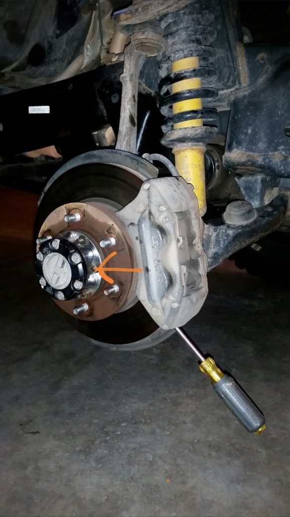

    Is there a way for me to keep the hub from spinning so I can loosen the 6 nuts at the base of the hub? Manual locking hubs

    $400 til I send in the old ones. Then I'll have only spent ~250!

    Maybe I'm not thinking straight, never worked on my old manual hubbed Tacoma. But can you lock them in and put it in park so they don't spin?
    Hmm, not too bad... Where did you get them from?

    It's a total bitch without an impact gun. Impact gun blasts it right off.

    Answered my own question fellas. Stuck a screw driver in the rotor to keep the hub from spinning so I could loosen these nuts with a small 12mm wrench. Not even remotely difficult to loosen..at least on this side. The cv's came from camelback toyota :D
    Edit: I should note, I hit these bastards with PB Blaster the night before. It might have made them much easier to loosen them. I'm pretty sure it helped a lot actually lol

    Ah, another good method haha
    Definitely invest in an impact. Love my cordless one!
    Thanks for the info, will be replacing my OEM CV's at some point. Just need to choose between remans like yours, or remans from CVJ.

    Haha yeah I tried locking the hubs putting the jshift in 4wd and popping her into 1st gear but the hub was still spinning. So the screwdriver came to mind. And those aren't remans man those are brand new cv's man
