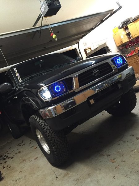

    And yes the lights still shine through fine.

    oooh teh purdy colours:drool:

    Thanks man, same body style haha. Just some extra letters on the tail gate and a different front end

    I know. Just referencing the front end ;)

    That looks excellent. Nicely done. And I think out of the 3 1st gen front ends, retros may look the best on the '95s-'97s.

    Hadn't realized this was the reason, but yes, I completely agree with you!

    Thanks guys. I do love the 95-97s but think the other models look great too

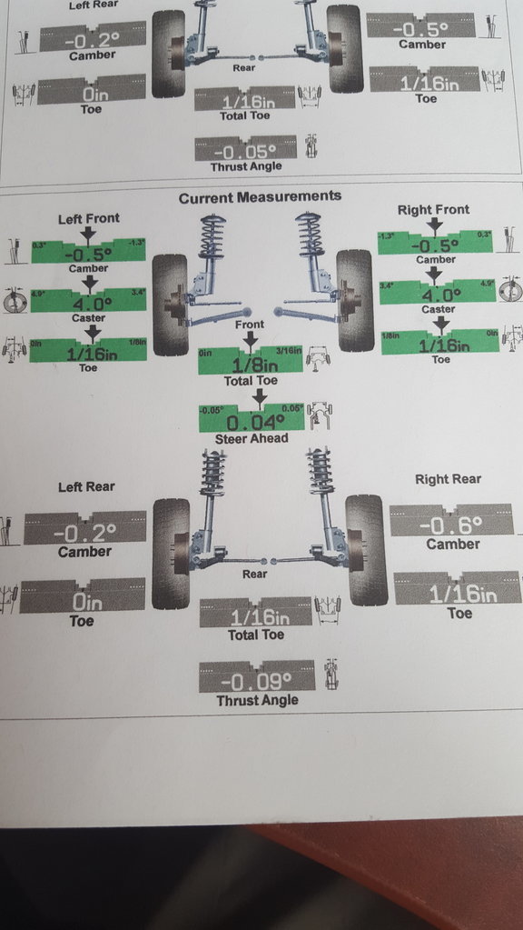

    Since this is a topic atm haha how does this alignment look i don't understand the numbers but i know when i need one -,-

    Well that escalated quickly lol. I quoted your post because it cracked my ass up. Pastry decorator! Classic:rofl:
    I'll throw in my two pennies.:crapstorm:
    As a ten year tech with hundreds of alignments under my belt, I agree just a little negative camber is a good thing, mostly for feel when steering into corners, and tie wear is negligable if you keep up on tire rotates. It lessens the feel of understeer. "Feel" is the operative word. 0° is just fine and will cause no tire wear. Anything over a -.3 will start to cause noticeable to extreme tire wear. 0° toe is also just fine and will cause no wear. If you live in Wyoming, like some of us lucky ones, where most roads are not crowned zero toe is great. However most roads are crowned so generally alignments cheat toe to compensate for the uneven surface, lessening the feel of pull to the right caused only by the road. -.05 is close to spec on most vehicles, and a good all around setting. Once again wear is negligible. Anything out of recommend specs will 1) create a harsh and sometimes uncontrollable feeling ride and 2) cause unacceptable tire wear. Even set within or on edges of spec can cause bad wear.
    More important is how each side is adjusted in relation to each other. Known as cross angles. If these measurements are outside of spec all sorts of weird shit can occur. Things like tire scrubbing, axle walk, vehicle wander, not tracking good, and strange popping noises lol.
    Contrary to @Caligula statement, those specs are given to create BOTH the best possible driving experience AND maximize tire life.
    Now keep in mind I use "feel" alot in this because most of it boils down to what a customer thinks their driving experience should feel like. This is my 2¢, take it for what it's worth. I'm just going off experience and the stuff that got me my ASE certs.:notsure:

    Here's my alignment sheet. I have aftermarket upper control arms and 285/75/16 tires, hence the caster. Steering feels nice and "solid" with the caster pushed out. This is the alignment spec I've been using for over a year now and there is no noticeable undesirable wear patterns. Rotate tires every 7-10 thousand KM.
