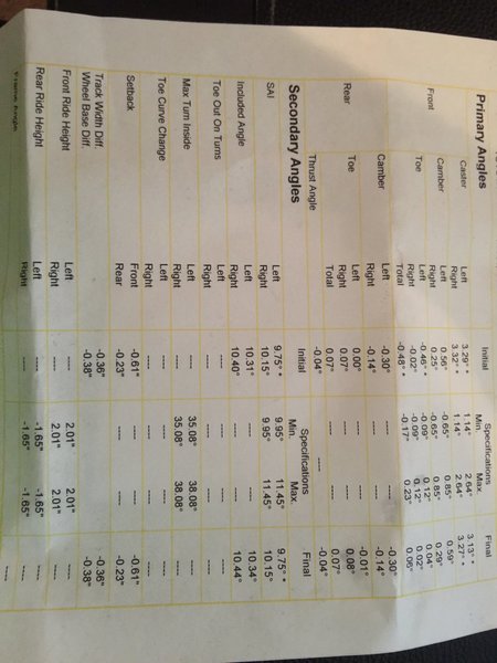

    Yea I'm betting this pulls right pretty good? Both camber and toe are pretty bad on the left front. May be some worn parts, Unless of course, you've just changed parts. I'd suspect you have a bad control arm bushing somewhere. Camber and caster can affect toe drastically. IMO the worst design on these trucks is the small tabs that the eccentric bolts sit in between. It wouldn't surprise me to see that that tab has been flattened and the eccentric moved. I saw a thread on here to reinforce said tabs, which I highly recommend..other than that I'd look for worn parts, but you certainly could use an alignment.

    Yep it pulled right like crazy after i cranked up my coilovers a little higher. the pic is before and after does the final look ok? it feels good now but was really bad before

    The report shows both before and after. It looks like about all that was done was a toe adjustment on the left. Camber and toe on the left are still not as good as they should be.

    That's shitty :( wish i knew a good alignment shop close by... only one i know cant fit my tires with 15" wheels

    Yea I didn't see the final numbers lol..printout is a pain to read..yea looks pretty good now.. The lift explains the caster. Yours is a perfect example of being dialed in to compensate for crowning of the roads.

    Maybe I am misreading it too but the final camber on the left still seems too high.

    You're right. .5 is a little much. I can see the left is cranked a little higher than the right..probably because of Tacoma lean. May be close to max without uca's

    thx guys ya shoulda noted the lift and camburg UCA's

    Sweet! Well if I were there to do it I'd hook ya up.. I agree with @Digiratus I think the camber could be a bit closer..dude probably got pissed and shipped it Lol..not too extreme though..
