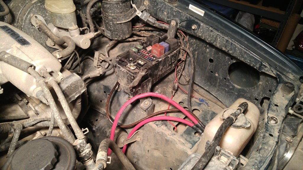

    Started the Big 3 mod
    All I can say at this point. I hate Toyota clips holy shit :frusty:

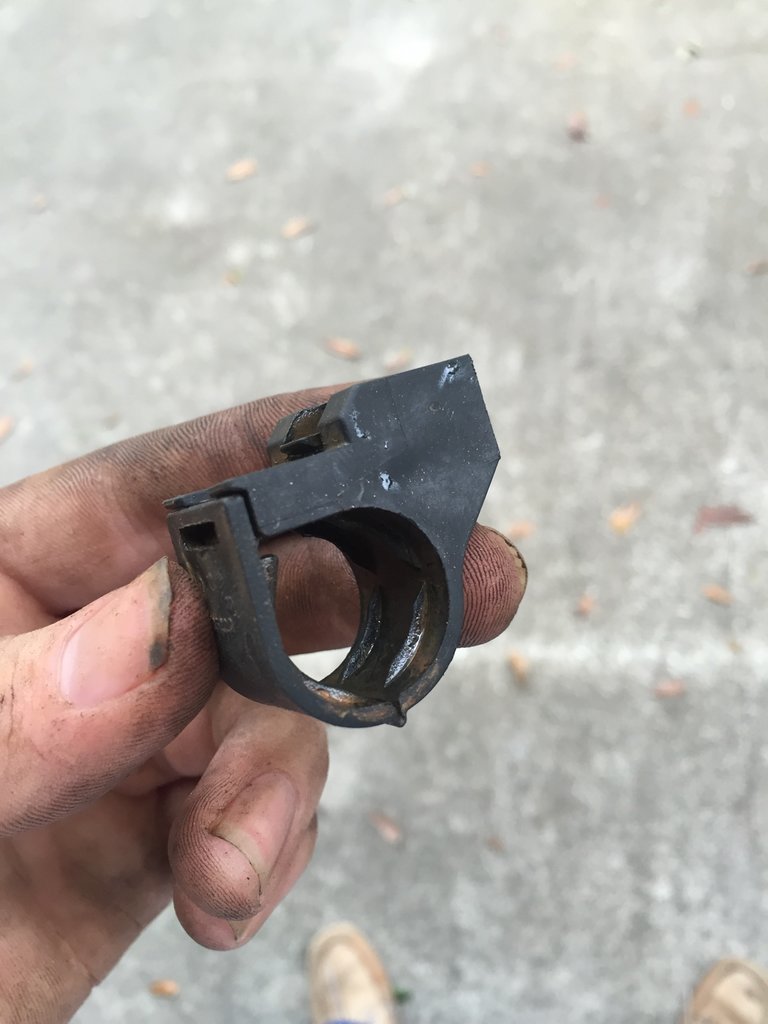

    Anybody know how the fuck to undo these clips? Not trying to break them so I'm not trying very hard ha
  9. Dec 23, 2015 at 10:33 AM
    Speedytech7
    Feb 20, 2014
    #123587
    58,449
    FCQM+VG Cheney, Washington
    It's less Tacoma and more mod
    Screwdriver up through the bottom and push in toward the part that hold the cable or screwdriver in the top and push out and pull open. Once I learned it seems easy but ujntil then I was fine with destroying them if it meant I got to the cable before next century.

    Which is top and bottom you're referring too?
  12. Dec 23, 2015 at 10:50 AM
    Speedytech7
    Feb 20, 2014
    #123587
    58,449
    Top is where your thumb is and bottom is where your index finger is. Hope that helps, the clips are a bitch so don't be surprised if you need a little bit of force.

    Fin! I ended up just taking one wire at a time out of the clip. Never got the damn thing to open but I made it work ha.
    It looks like a huge mess so I can't wait to get my fuse box in next. But I need some more small stuff to make it better and it'll look great.
    My PO had so much shit wired around things, I found a wire that is attached to the bolt in the stock fuse box and then goes back to my trailer harness and then its attached to something inside. Holy shit what a mess. I'll figure it out someday haha

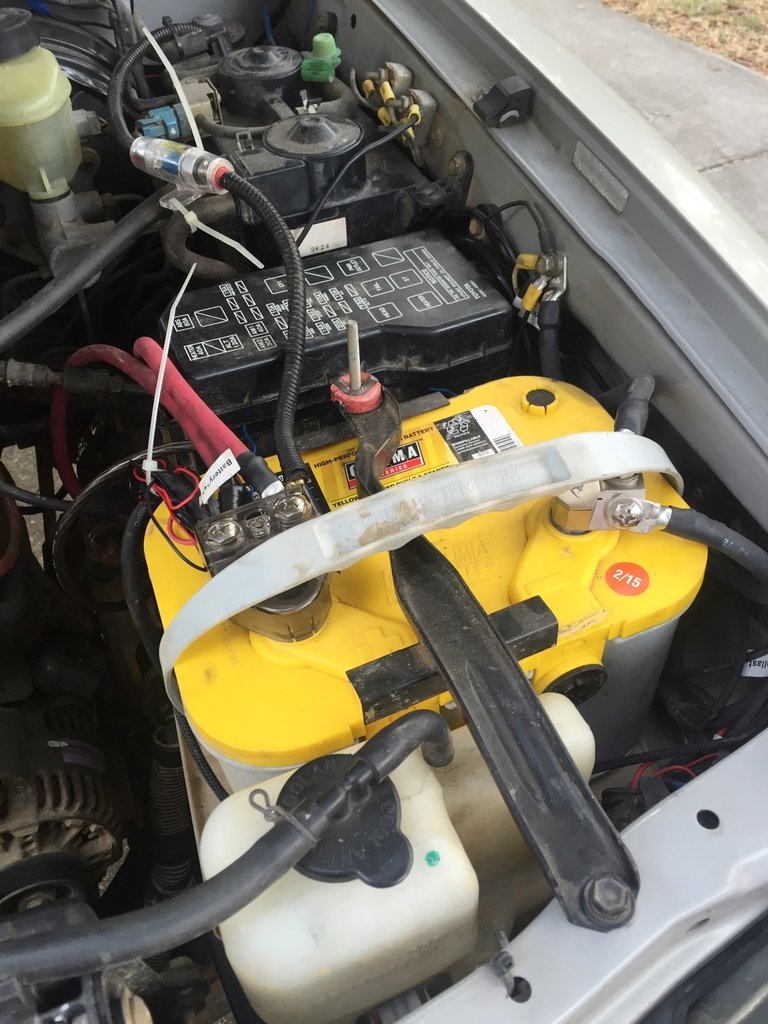

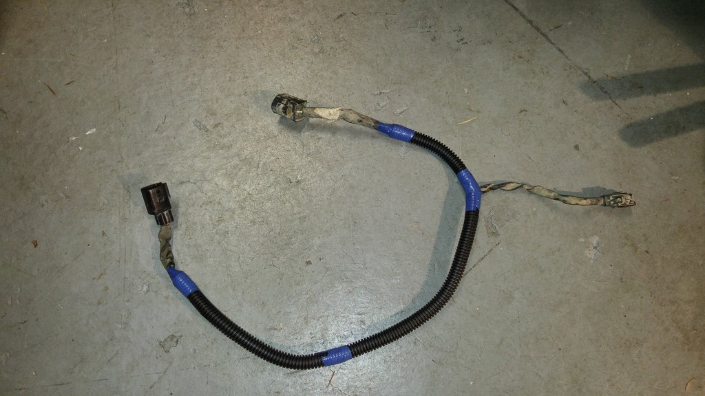

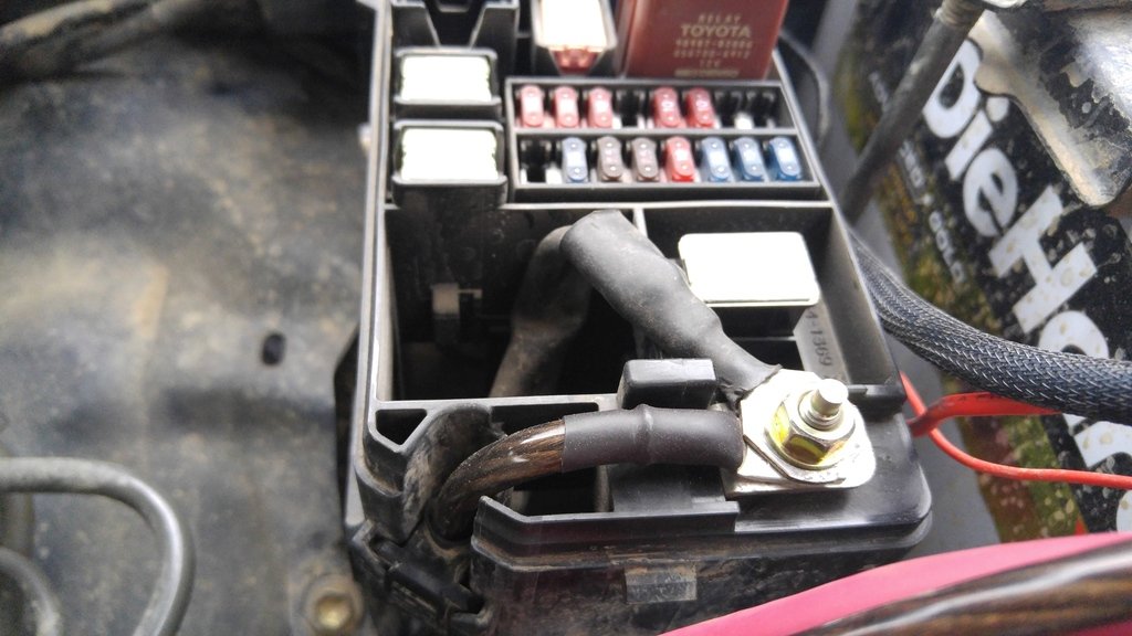

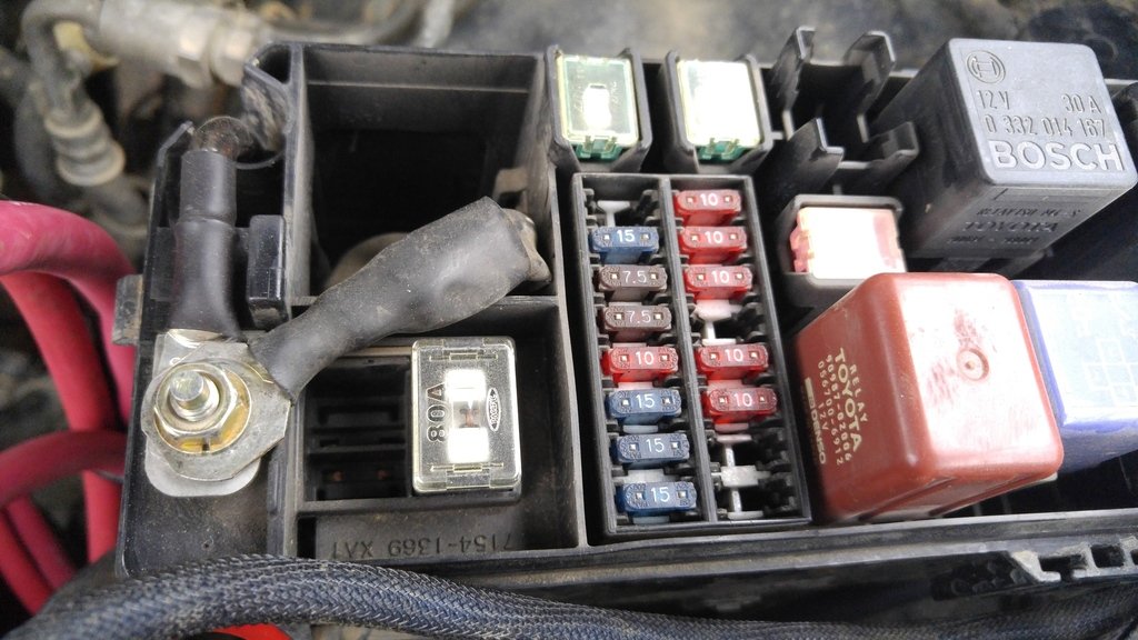

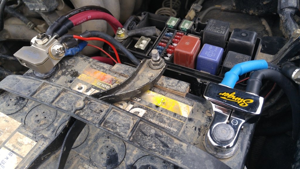

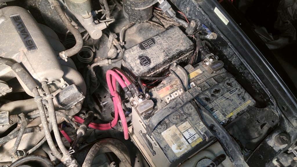

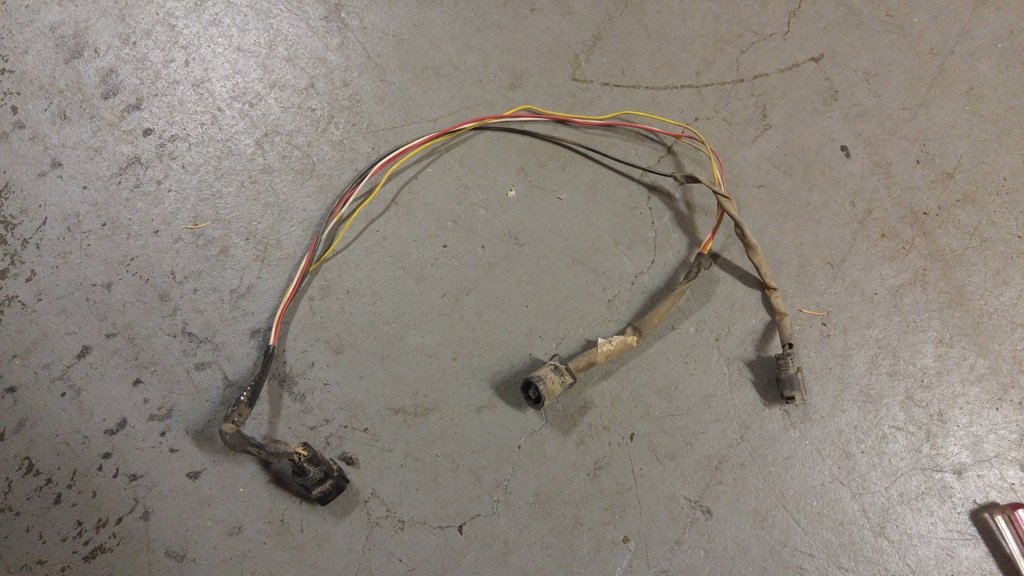

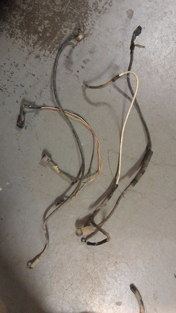

    Figured I'd post my Big 3 upgrade from @BamaToy1997 as well since some other members have posted theirs. I finished installing mine about 4 days ago so here it is.
    First just a bit of disassembly, took the old loom out and pulled out the wires I needed (the trigger and sense wires for starter and alternator)...
    Made a shiny new loom for the trigger and sense wires to protect them from my mischief...
    Then I began to lay the new wires in and figured out how I'm going to run them so they don't rub against things and stay protected and neat...
    After that I popped the fuse box in half and re routed the ring terminal that comes out the bottom so that it runs through the void space in the box itself and comes to the top screw terminal rather than run it externally (thought it would look better and stay better protected)...
    Then after testing everything I buttoned it up and ziptied some of the cables in safe areas and to the old loom holders...
    Just a short while later I discovered that the negative terminal supplied with the kit didn't fit my battery all that well (Not @BamaToy1997 fault, my battery has a small post), even when fully tightened down so I swapped it for another ring terminal accepting battery terminal (wish the new one was less blingy but I'm sure it'll be gross in no time with the way I drive) and that concluded the install...

    My negative terminal was to big too. One time my truck didnt start so i had to jam a spare fuse in to take up the space. Been there for months...
