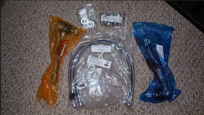

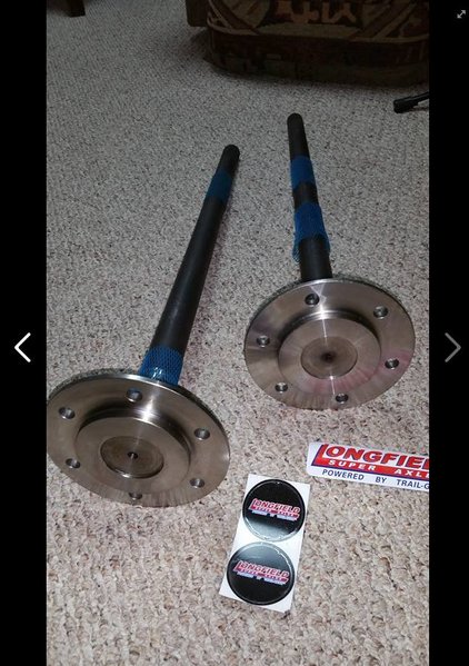

    Just picked up some goodies from my front porch a bit ago.
    TG 4340 chromoly longfield super axles, stainless braided extended brake lines, outer tie rod ends.

    If you have the TRD e-locker rear those shafts will not fit. All e-lockers are ABS housings regardless if the truck has ABS on not.

    No E-locker option for my 2.7 doublecab. I have a powertrax no slip in it and non abs housing.

    Fine then, carry on.
    Didn't want you to press in the studs then have to return the shafts.

    One thing that has me stumped is this statement on Low ranges web site.
    "2001+ Toyota Tacoma's without ABS will need 79-95 Minitruck bearing pockets and bearing kit for these axles to work."
    Parker at Lowe Range checked multiple times with the shop and said to use the standard rear bearing kit. They were out of the ultimate bearing kit so I just got some from oreily's.

    Thanks for the concern.
    I only ended up with 6 new wheel studs, will I be able to salvage 6 more from the old axle shafts? Or do you reckon Toyota might have some in stock?

    Hard to say, they are a relatively common replacement part.
    I like to spread the word on the TRD=ABS thing to save folks the cussing I went thru when I "thought" I had all the parts together for a seal/bearing job on mine.:(

    I never heard of that, standard seems right to me. There was a bearing part# change around 01. I have changed out plenty but never compared the years side by side. The OEM shaft part #'s are the same for all 4wd/prerunners, just different between ABS/TRD and non ABS (talking 6 lug).
