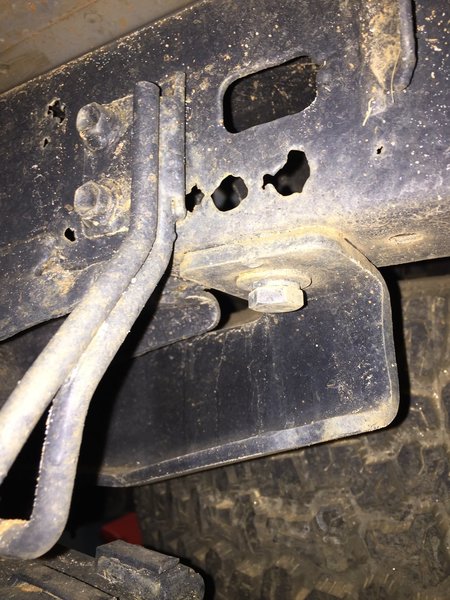

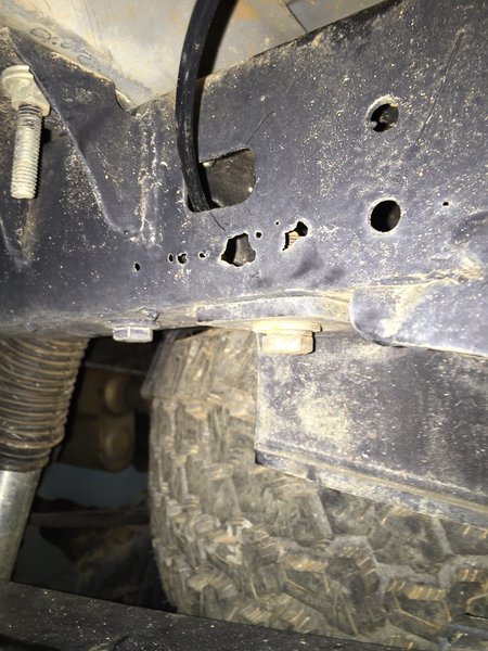

    None that I can see, just the giant holes

    Looks paper thin, weird though it doesn't look like there's rust, is it a new truck? Did the po paint it? I'd hit the frame and see if you make any holes

    It's been painted/coated with something, there's black paint like stuff on some other parts other than the frame too and some drips here and there. Is this major enough to cause any problems?

    Looks like that whole section is weak. Where it is past the shackle mount should be fine to drive but i wouldnt trust towing anything from the hitch. Its an easy spot to work on. Id take bed off and repair it.

    This, but also check the rest of the frame, just use a hammer and go up and down the frame.

    Wasnt toyota offering a recall on frames and lower ball joints? You could always plate it but it doesnt look bad. How long have you owned it? Weird that there is no rust.
