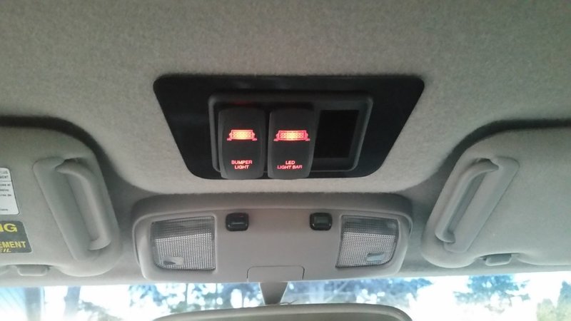

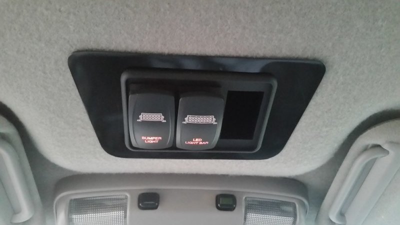

    Did you make the part for the switches? I have always wanted to do that.
