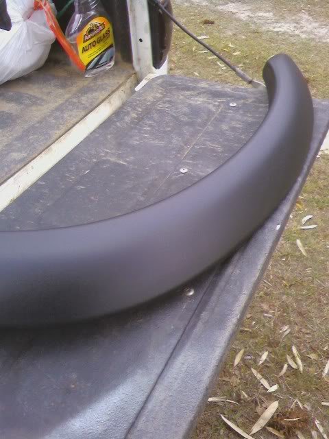

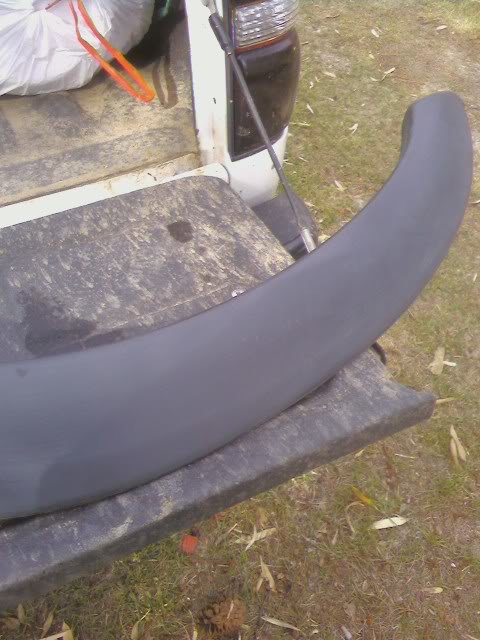

    Bedlined my flares.
    Before:
    After:

    That looks really smooth, what did you use?

    Let me know how that holds up over time. What prep work did you do? What brand of bedliner did you use? Can or roll on?

    It actually doesnt look that much difference in the pic, ill have to go get my good camera and upload how it looks on the truck but all i did was clean them with this acid like rim cleaner we use at work that eats the hell out of grease then washed that off and scrubed it with a rago to get all the dirt possible off, then used some sand paper and did a light sanding on it then hung the pieces in the garage and sprayed em down and i used the rustoleum bed liner spray from wally world, since i had 2 full cans in my toolbox for slider touchup and my flares were already off i figured why not:cool:
    They turned out great, going to get camera now.
