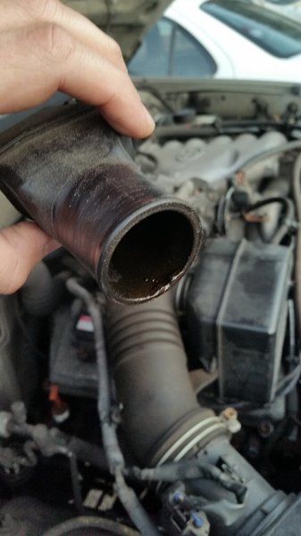

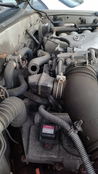

    the hose routes down behind the plenum. it's attached to the valve cover or hose that runs under the intake. it has minor suction pressure (the hose not the intake tube) so not sure why it has oil, mine does too. I disconnected the hose and no change, but when I removed the elbow piece it killed the engine due to an abundance of air.

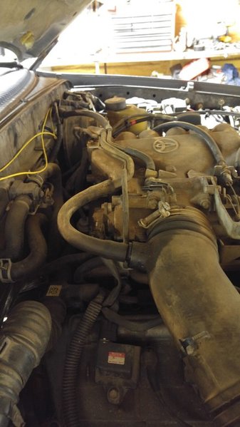

    I don't have that little plastic box sticking out of mine. But it's the same hose. It has suction pressure when taken off of the intake? How can it have suction pressure but then be hooked up to a vacuum?
    I looked in my service manual and labeled the pcv but not this hose. It has it in the picture but it's not labeled as anything.

    Okay after doing more research what Caligula said makes since. The hose is filtered air that pics up the blow buy vapors and then they go to the pcv. It makes no since then why oil would be there unless the pcv isn't venting the blow by properly and it's having to go through that tube instead.

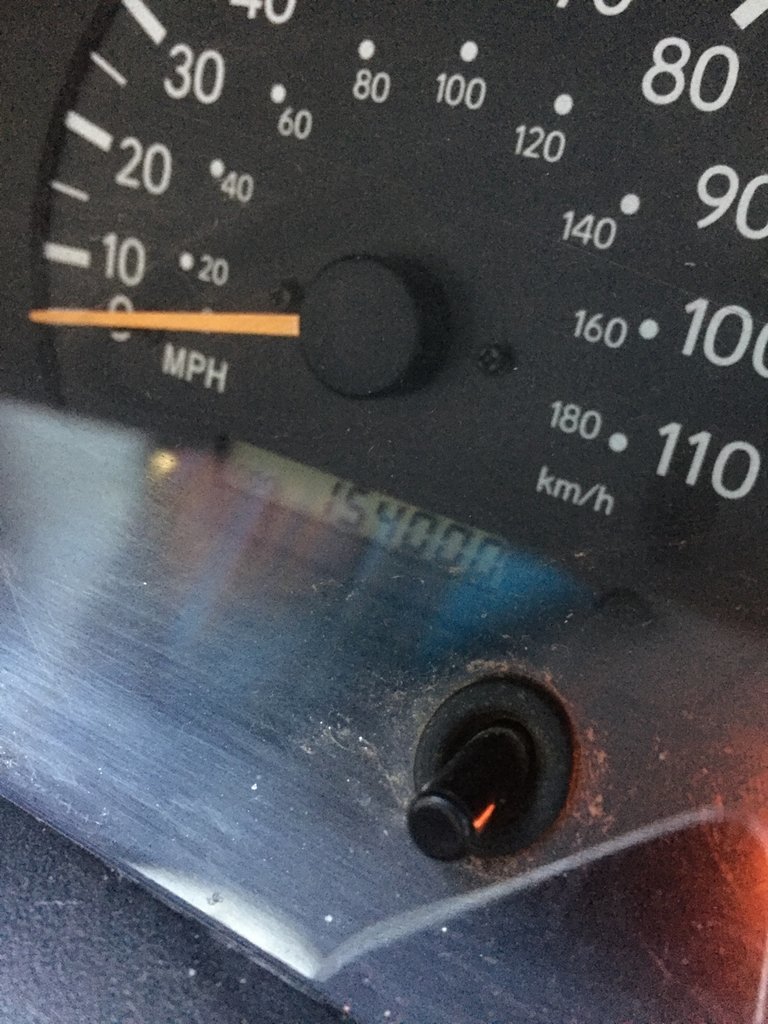

    I have the same amount
