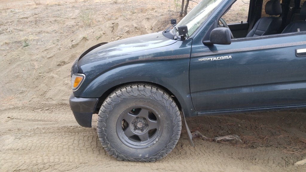

    Got to drive mine today5th time in 10 months

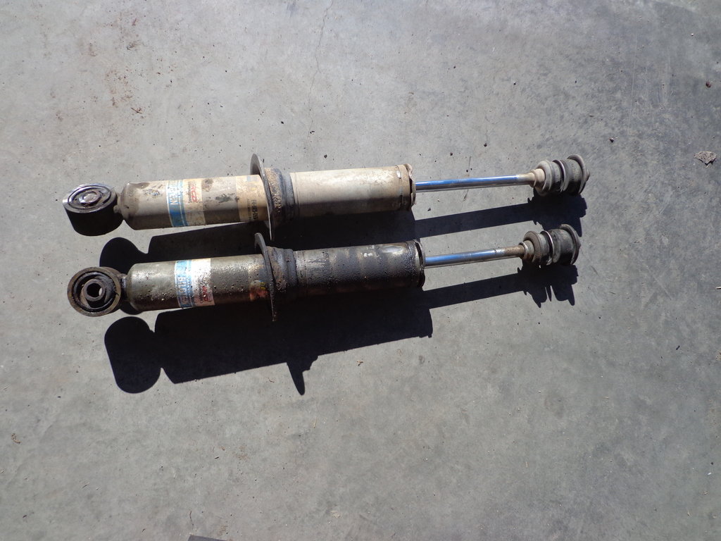

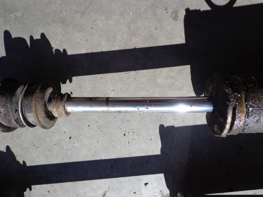

    This count?
    Note the different extended lengths, oil everywhere, and bent shaft.

    Thank you sir

    Thanks Ben, been a ton of work but I am very happy the way it turned out:)

    Looks like well used parts! Congrats! looks as though you have plenty of miles on them, including plenty of use offroad!

    They did not have a ton of miles on them, and that was before a lot of my serious wheeling, but yes, more than just street miles on those.
