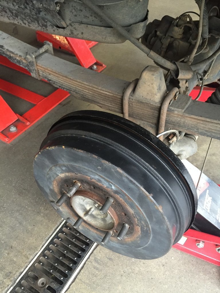

    I'm up here getting new tires, techs tell me my axle seal is blown. Can Toyota dealer techs install an axle seal to save their lives? What gives?
    This is the second axle seal I've had in less than a year.

    Diff breather not working? Grove wore in the sealing surface?

    I was actually thinking about the diff breather being clogged.. It's always been the driver side seal that start leaking. I didn't think about a groove being worn though. How would you be able to check?

    By pulling axle. See if your fingernail catches the Grove.

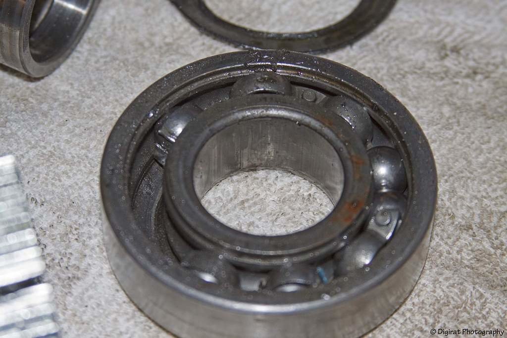

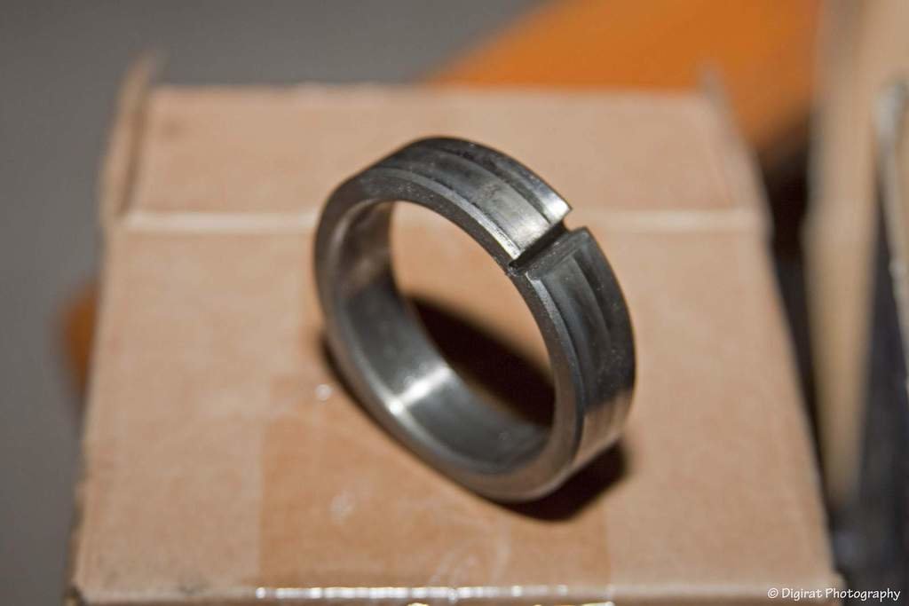

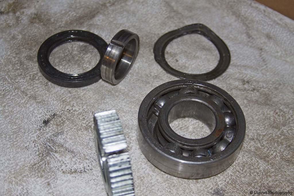

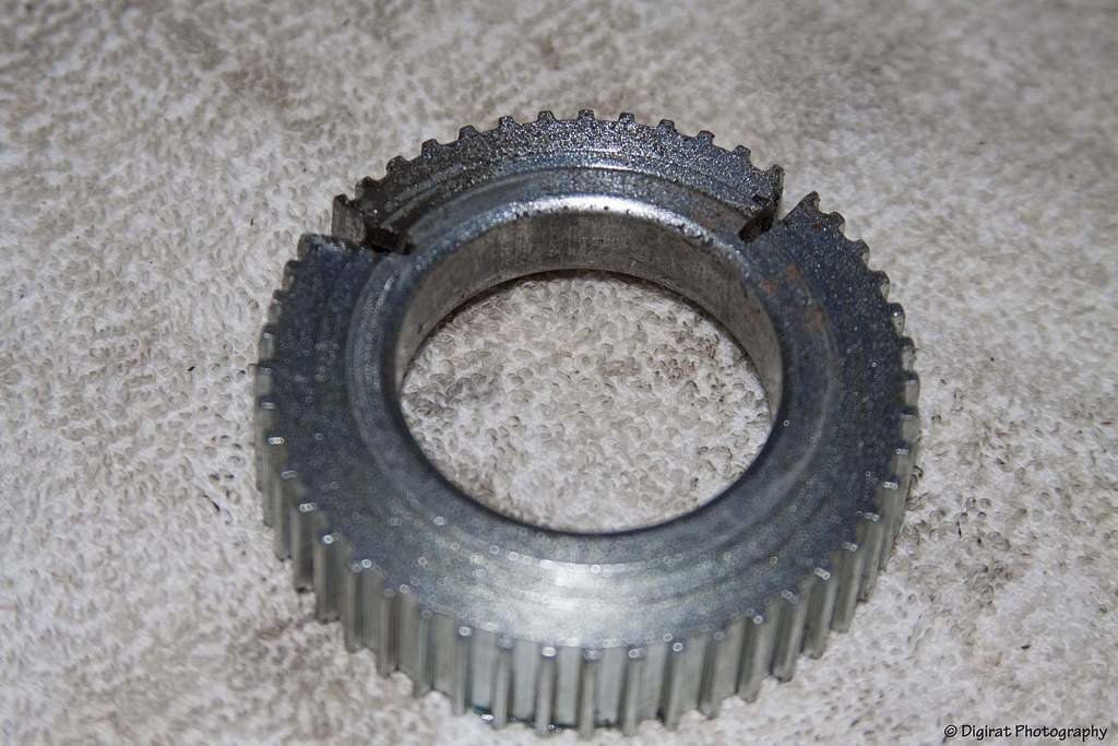

    I've had a similar experience. My driver side seal started leaking last summer so I had a shop replace both sides. All new bearings in the process. Well, driver side failed within 2300 miles when I was in Canada on an expedition. This time took it to a Toyota dealer up there. So far, no more trouble. :fingerscrossed:
    It is my understanding that it is an easy job to screw up. At least that is what I've been told by the lead Toyota tech who fixed it the second time. Here's the carnage from the second fix.

    I dunno an axle seal is one of the easiest fixes on our trucks. It could be mud, a bad bearing, a grooved shaft, an a cheap seal or a few other things.
