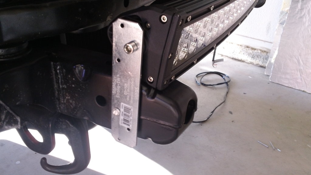

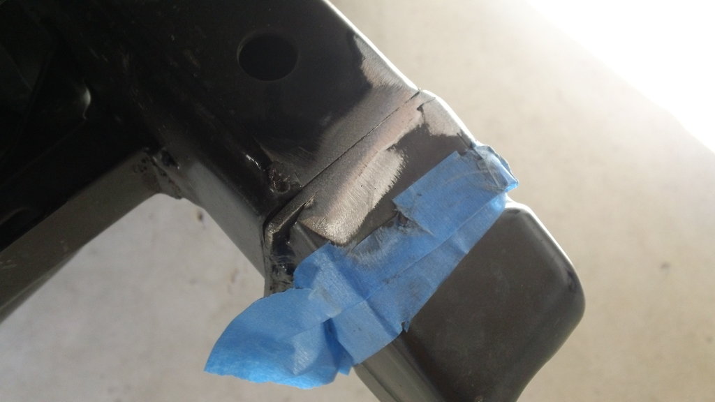

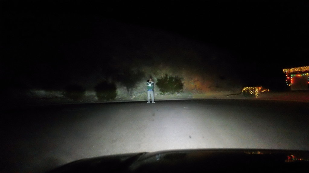

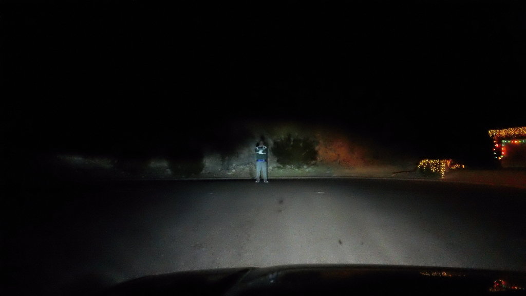

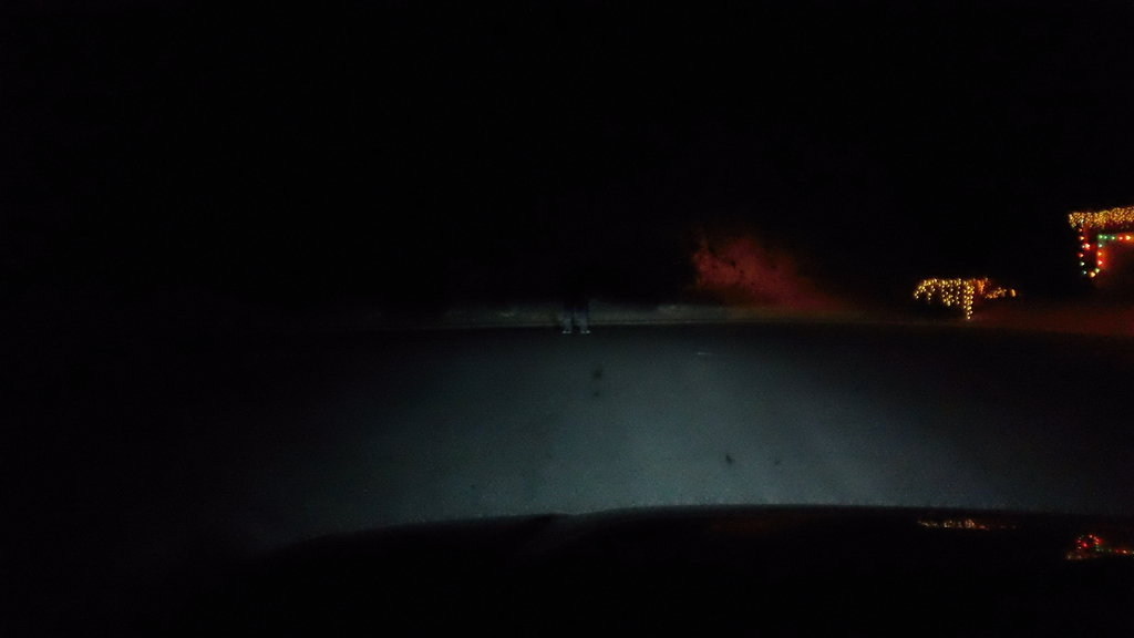

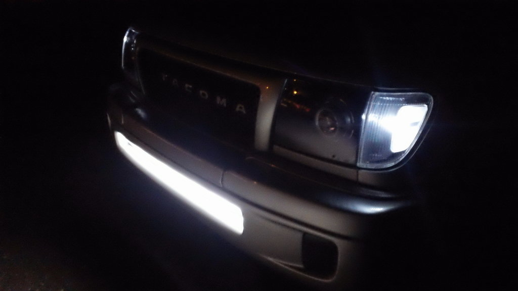

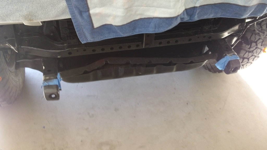

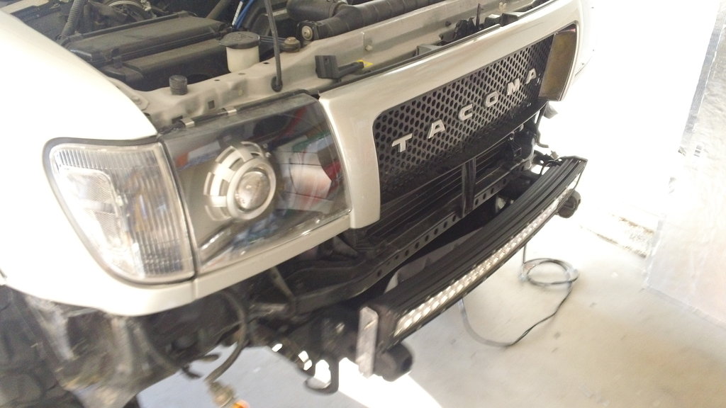

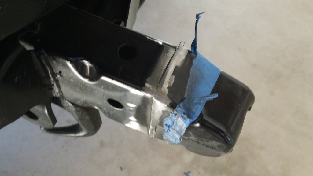

    I ground down the flange on the frame horns so the bar would sit flat at the height I wanted it. Then I used some metal tabs from the hardware store as the mounts. This light bar was the exact length of the outside edge of the framerails which made it easy. The hardest part was drilling through the hard steel of the frame.

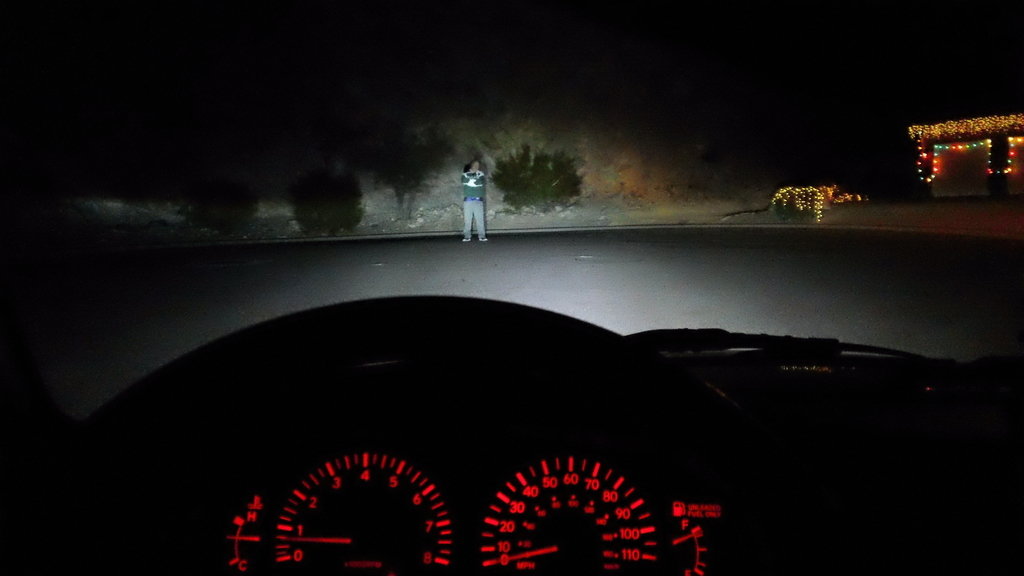

    Low Beam
    High Beam

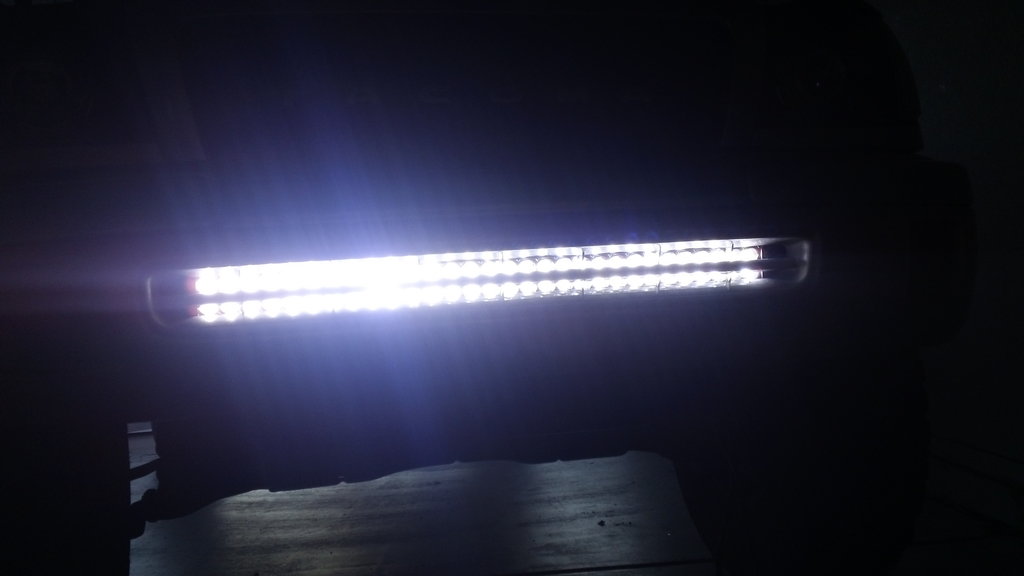

    High Beam with 32" Light Bar

    Awesome.
    I love the red of the gauge cluster too. Have all the bulbs sitting on my work bench.... just waiting to be installed.

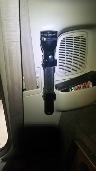

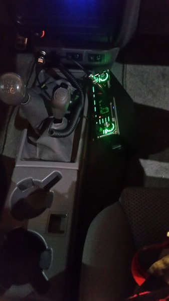

    Just installed my new CB and relocated the Mag Light.

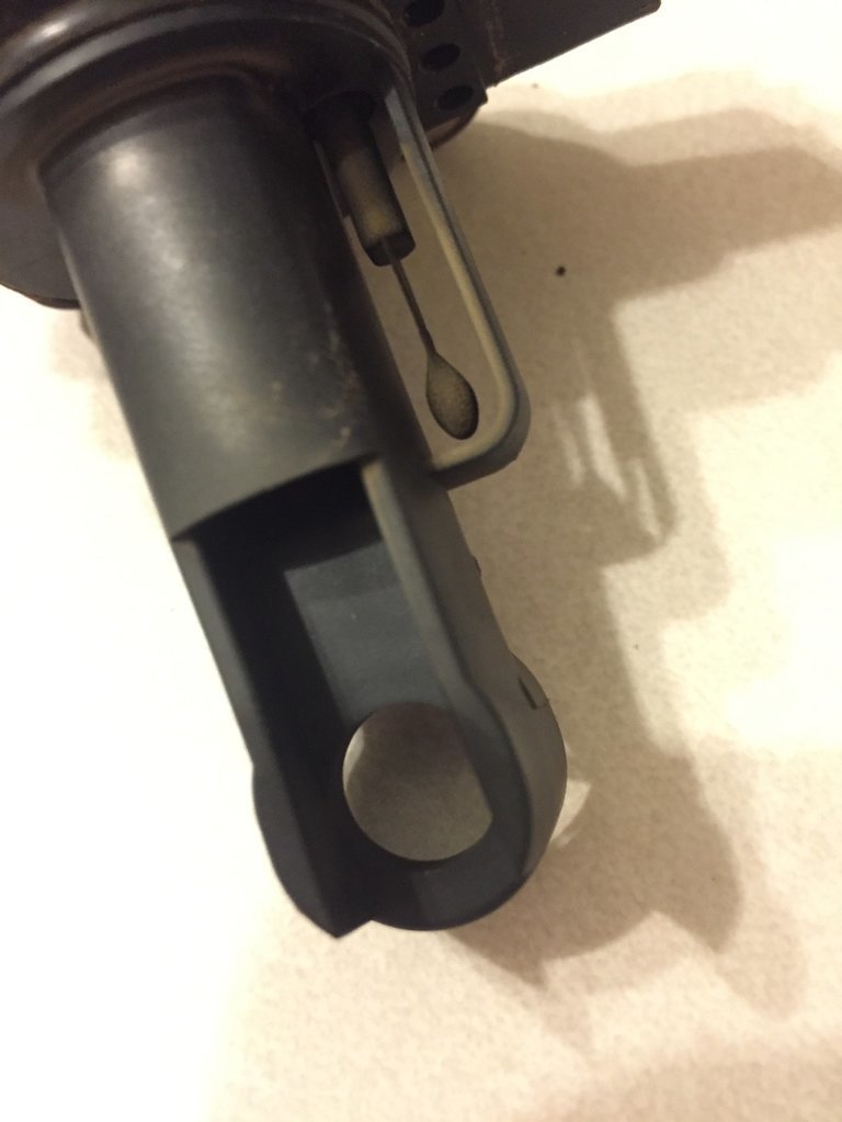

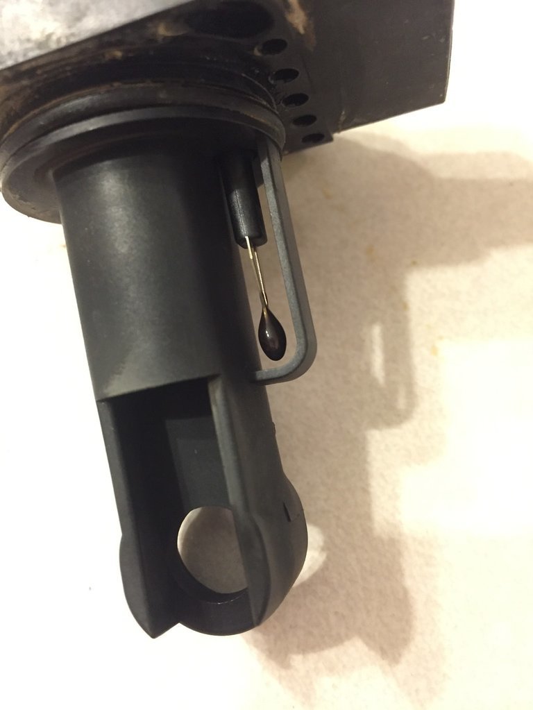

    This was so easy to do, I don't know why I waited so long to do it. I had the dealer do it maybe 50k miles ago, but the can of MAF cleaner I got said to do it every air filter change!

    Not very impressive for a 32"?

    I've always liked Mag Light mounting. I might end up doing that some day.
