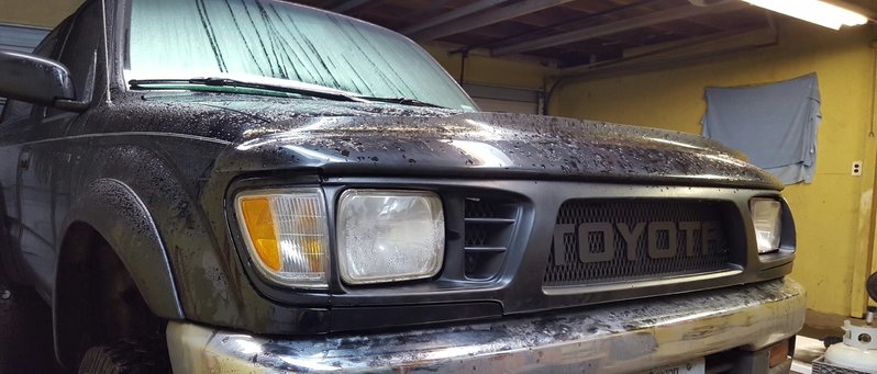

    Gave the yota a face lift today :cheers:

    That looks great!

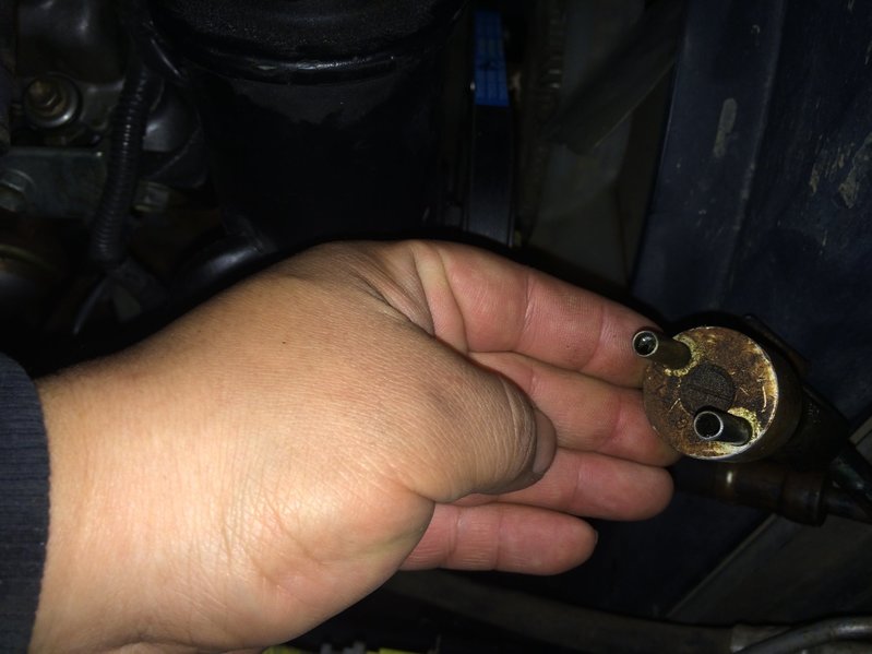

    I think I was sold the wrong power steering lines. I have a connector for a sensor that isn't on the lines. Any 1st gens could take a pick for me of the lines that connect to the pump so I know what I'm looking for. That's what happens when you trust ppl to give you the right part. Anyways.... So a pic would be nice. Thanks.

    Ray, this is what mine has, it's just a couple vacuum lines that run to the intake. no plugs for sensors or anything. I have no idea what it does and doesn't seem to change anything when I remove the lines, but I have left them on anyway. I'm not sure why a pressure sensor would be needed on the PS system.
    At the very least, plug the ends and see if the ecu gives off any faults when you are driving.

    Were talking about the PS "idle up" switch. It senses load on the PS system and lets the ECU know so it can better maintain a stable idle under high steering loads.
    At least some of the 4 cyl's used vacuum (big fitting with 2 vacuum lines) and a VSV. At least most of the V6's just used a simple pressure switch.

    Thanks Brett.
    Thanks bud. That's the pic I need. :thumbsup:

    Can't believe i never caught on to that, every time I get in and grab the steering wheel, the idle would bump up slightly :anonymous:
    Learned something today.
