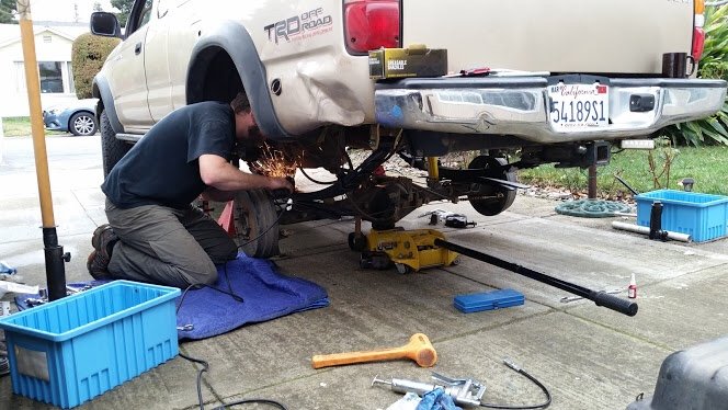

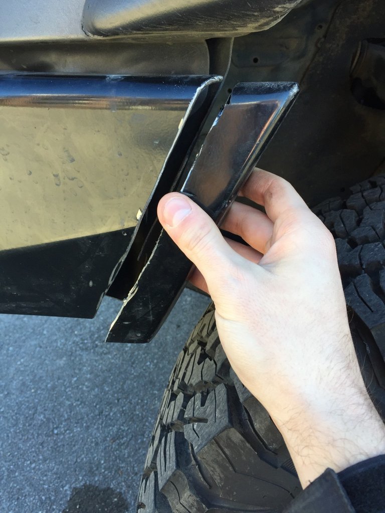

    Y'all think this is enough to stop the rubbing?

    Only one way to find out!

    True that. I don't know why I waited so long to get an angle grinder. These things are fun :sawzall:

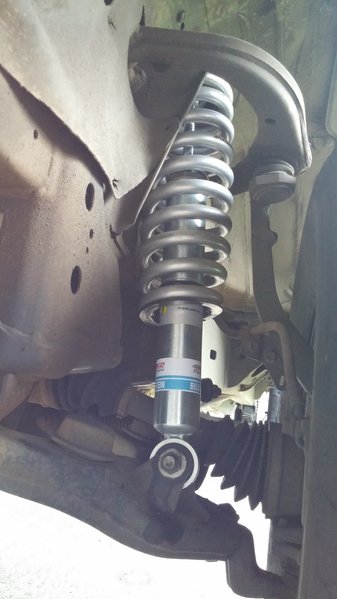

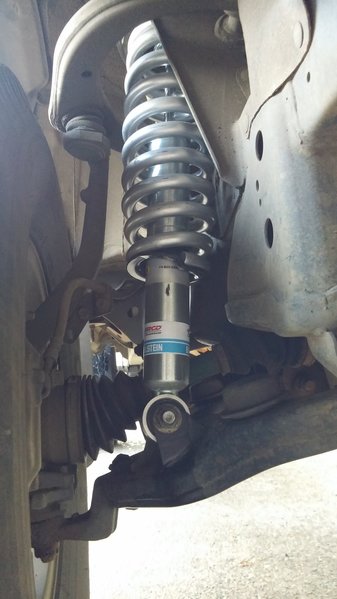

    Installed my lift.
    How do the cv angles look?

    Ah, the boot killer lift. :D
    Honestly, the axle angles look high. Looks like your inner boot fins are touching. They will not last. Any vibs?

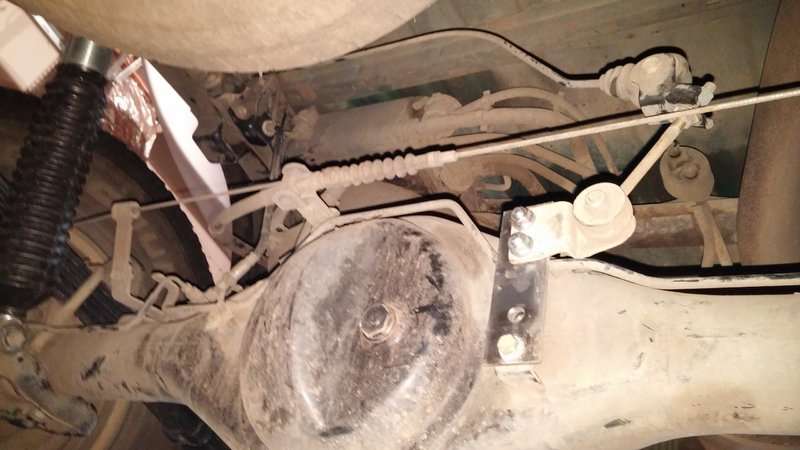

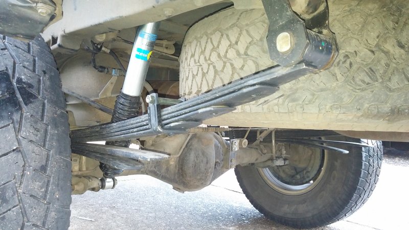

    just got my mid travel rear end done, and did some testing in ocatillo
    went from 8in of travel to about 13... now i need some LT up front

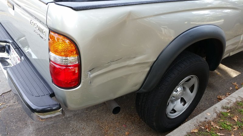

    Could be worse...
    I took the wrong line and bumped into a boulder.

    High.
    But thats because you put 620lb coils on a truck with stock skids, no bumper, no winch, hell no additional weight what so ever.
    You inners will be torn within 3-8k miles depending on how much offroading you do id guess.

    If I were you I would weld something back on the edge you created, that edge will slice your tire if it hits.
