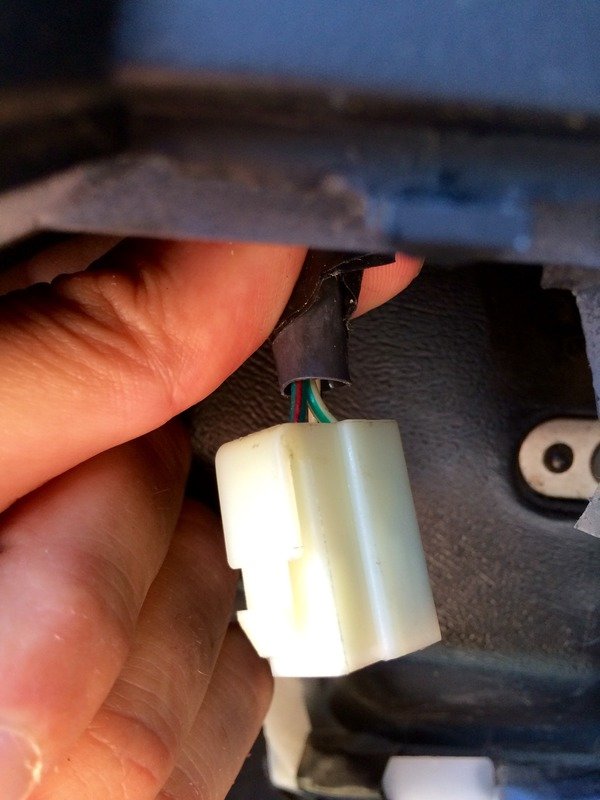

    I had to use a toothpick to bend the little copper pieces inside to hold the LED bulb base. It's not super tight but I think it will hold.
    maybe they are for a switch (ECT, Clutch Start Cancel)? OORRR the 2-pole is for the keyring light (option package for '99-00)?

    BYJOSHCOOK

    That's what I would check ^^^^ since the 99-00 came with the keyring light. But if its manual check to see if the clutch start cancel works

    not all of them, only the ones with the package for convenience lights

    Where are the plugs located exactly? Sorry if I missed this.

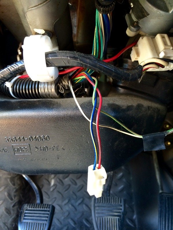

    Behind the kick panel kind of behind and to the left of the steering wheel column by the diff lock dimmer etc.

    Like these two?
    1st one is right where you are talking about. The second, smaller one, is below the steering column. Never figured out what the first one was so I cut off the connector and used it for my illumination/dimming hook up for my switch panel. The second one seems to be for the ignition ring light (which I do not have).
    Although when I tested the second one, it was always hot. With the door jamb switch on or off, didn't matter.
    Here's a pic of the wire colors for the clip above

    FYI, for the first clip pictured (under the diff lock):
    G-R for positive, G-W for negative. And it's controlled by the dimmer knob/switch.

    Weird I wonder what it could be for!
    Yeah those are the two!
